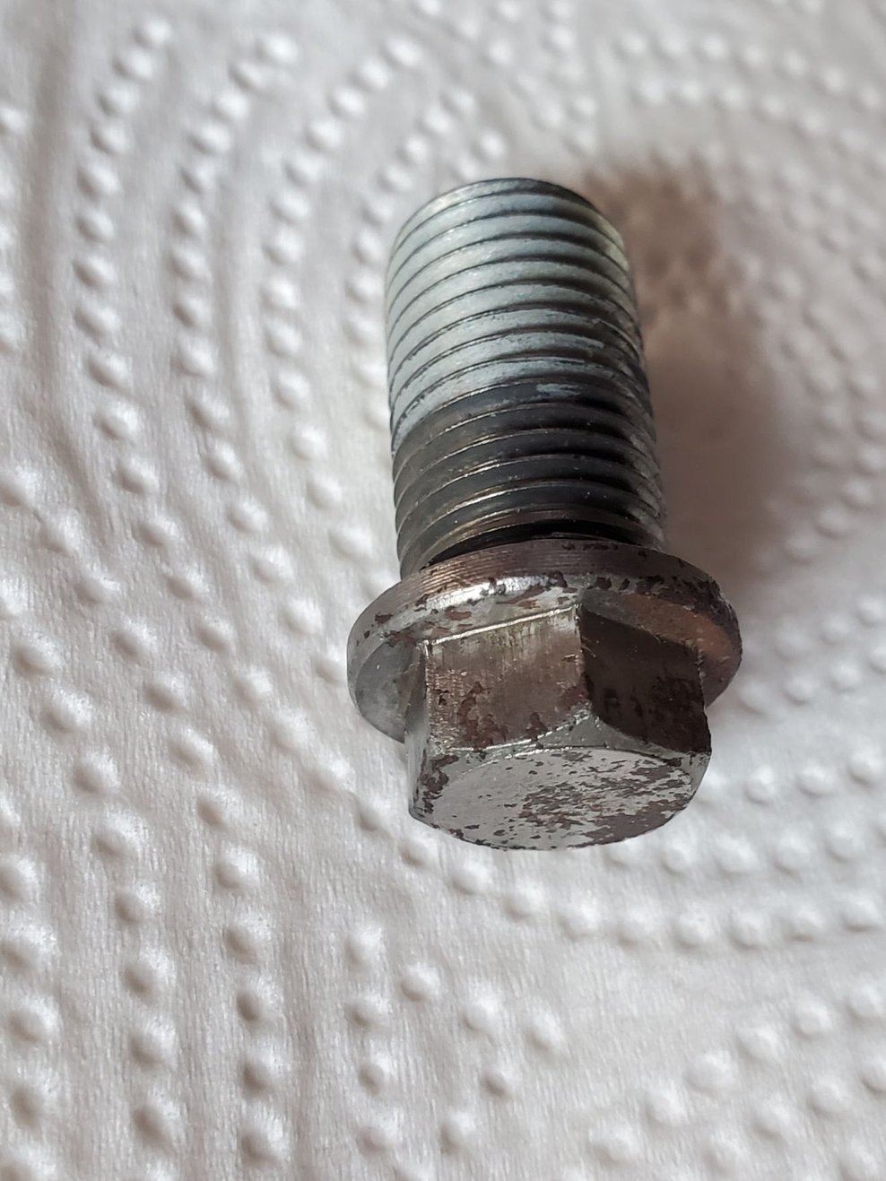

While waiting for the zinc i did one wheel bolt in nickel. It was just a quick test, scrubbed the wheel bolt with an sos pad then dunked the head in the nickel for a few minutes. It does look much better. To remove rust I would typically sock the part in vinegar for a day.

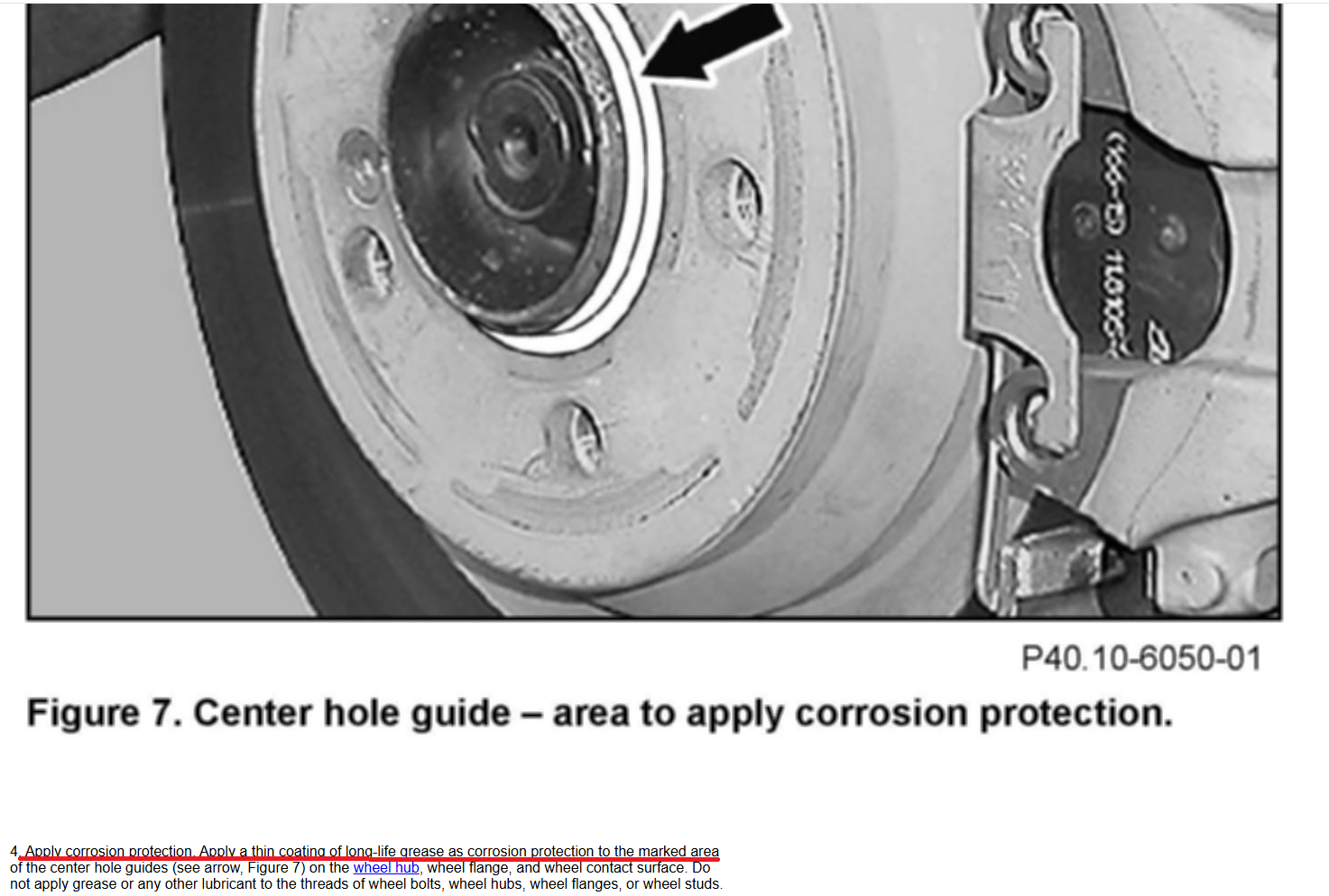

I was looking thru the manual and came across some useful info. For the brakes it mentions using a zinc dust paint so ill have to research more on the topic.
Heres after dunking in the nickel for a few minutes.

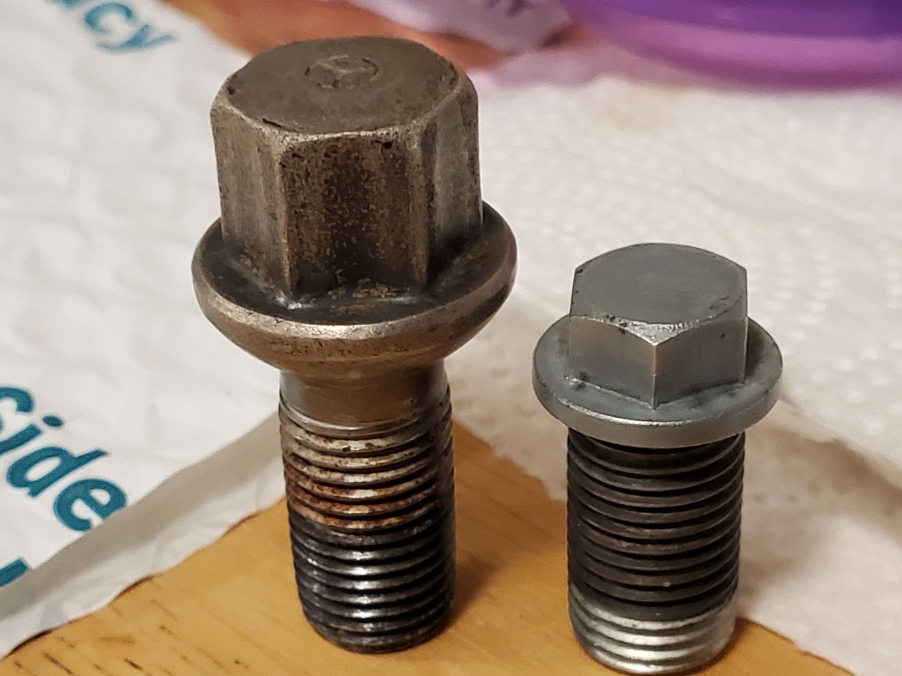

So far I have only played around with nickel electroplating. For the nickel plating solution I use vinegar and mix in a little salt, use a stick of nickel hooked to the positive and a stick hooked to negative and run it until the positive is fully dissolved in the solution. For the power supply I just use a standard 5v 2amp usb type phone charger. To plate a part I hook a stick of nickel to the positive and then connect the negative to the part and dunk it in the nickel solution for a minute or two.
I tried doing the same with zinc and it didnt come out good. The sticks of zinc turned black, the positive stick was producing alot of bubbles which I dont think is right. I unhook the power and it still will bubble. I think I was using too many amps, probably too many volts too. I have to find a different solution mixture, I read i should be using distilled water with just a little vinegar mixed in, maybe add some sugar.
I tried doing one in zinc but didnt come out good. I probably didnt have it clean enough but i had to use the car so was in a rush. I tried it on an old drain plug also. I read about hydrogen embrittlement that can occur and make the metal crack when plating so I didnt do the threads at all.
Heres after I cleaned off most of the rust. Still some rust left that wouldnt easily scrub off with steel wool.
Heres after. The wheel bolt coating looks black at areas.

First let me say that your zinc plating doesn’t look bad. Maybe not perfect, but that’s probably a cleaning issue like you said.
The sugar you heard about is a brightener. It might give the results you’re looking for. For the voltage, it think your 5V power supply is okay, but it might be depositing the zinc a little too fast. That can lead to a powdery coating that doesn’t want to shine.
Here is a post of a person doing zinc plating on car parts. He’s using honey as the sugar.
https://www.gomog.com/allmorgan/ZincPlatingAtHome.html
