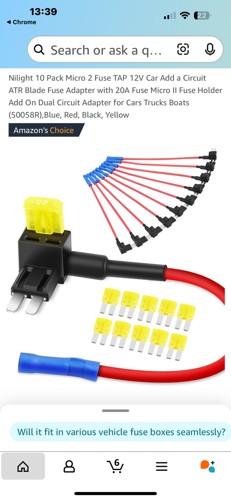

Mar 14, 2025 | 02:42 PM
If you are just looking for a key on hot fuse/wire them you can use one from the rear Sam. Just use a fuse adapter similar to this one. Just be sure to get the right size fuse like mini, micro etc. Whatever size matches there fuse you need to get power from.
