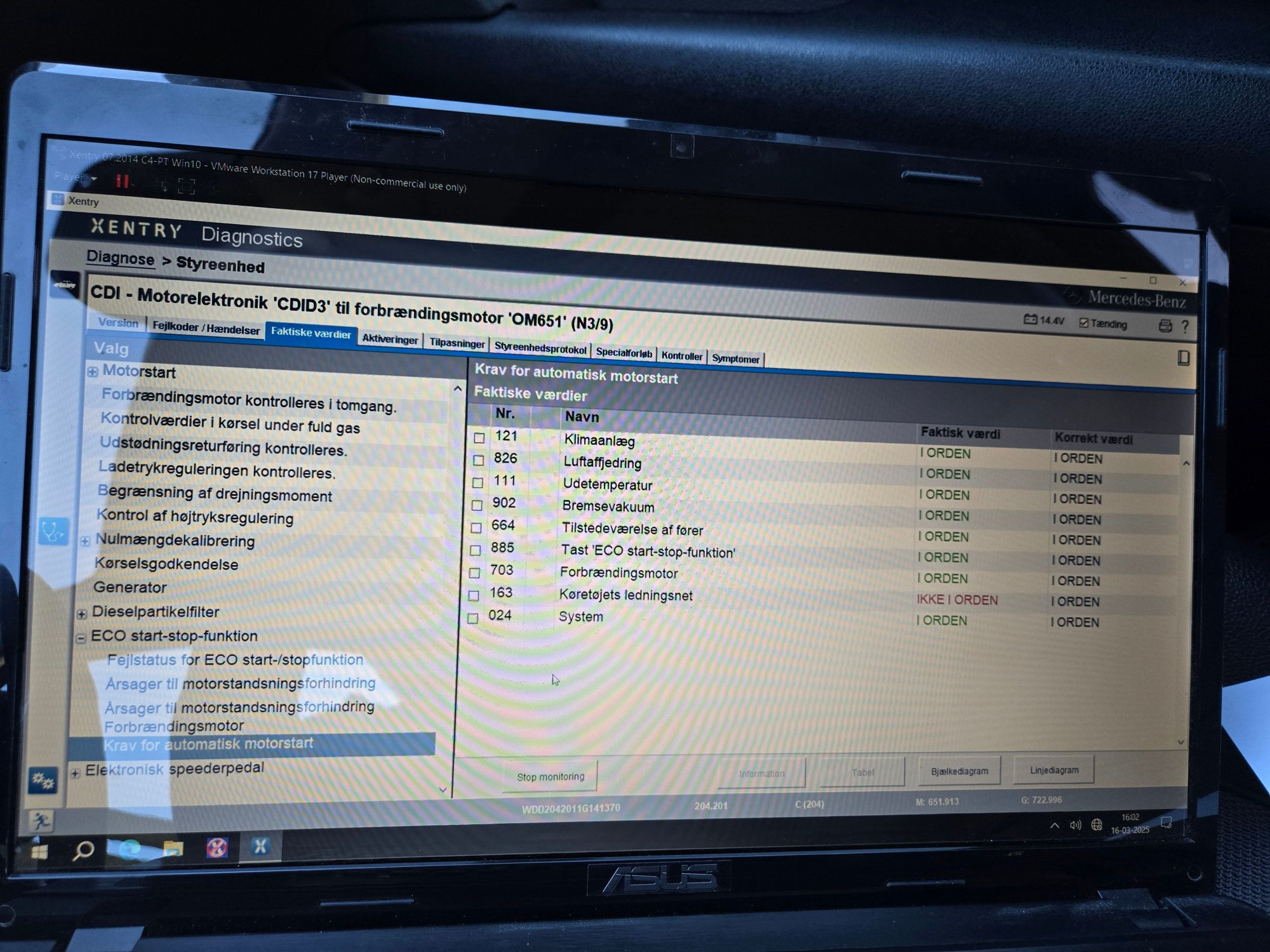

Hello Everyone.
I wondered why my ECO dissapears shortly after a short drive (Yellow as from beginning, then dissapear)
The ECO button do not function (no green LED)
I runned a Diagnose test and this say "Vechicle Wiring grid: Not in order"
All other fuctions is OK.
So my question:. Where shall i start to look/check the wiring for this part of system.
Sorry for the Danish language.

Your car could have a possible bad/loose ground somewhere. What is interesting about your screenshot is it appears to have passed the ECO function test. Which will usually fail if there is a problem with that system. Without prior information, It’s very possible you have two separate issues.

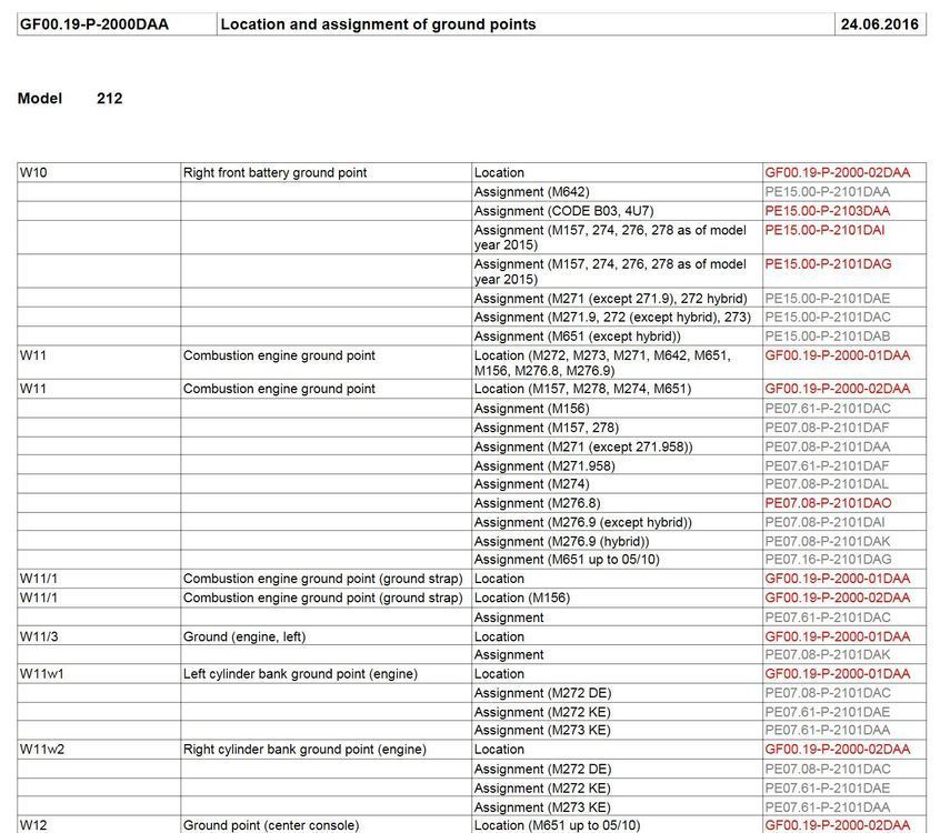

Since you probably have a copy of the WIS. There is a section on the ECO circuit of your car, It will show all the ground points and their locations and some testing info. ( see below for an example) ) You’ll need to test the circuits involved for resistance to confirm. Chasing bad grounds is one of my least favorite things to do, but left unchecked it can lead to some other unintended consequences.
