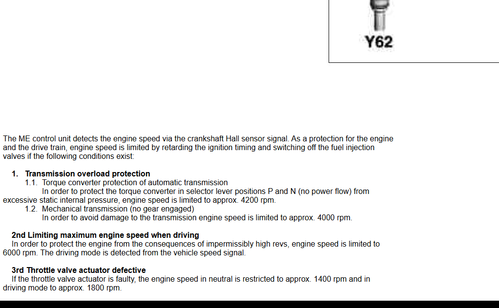

I have no personal experience with this issue and dont have that engine.
I would expect to see some type of fault code/codes when this occurs. I was looking through the manual for my M272 and a fault with the transmission appears to trigger a fault code of some kind and limits the gearing, not sure about engine rpm. I did come across something for the throttle valve actuator that will limit engine rpm.
