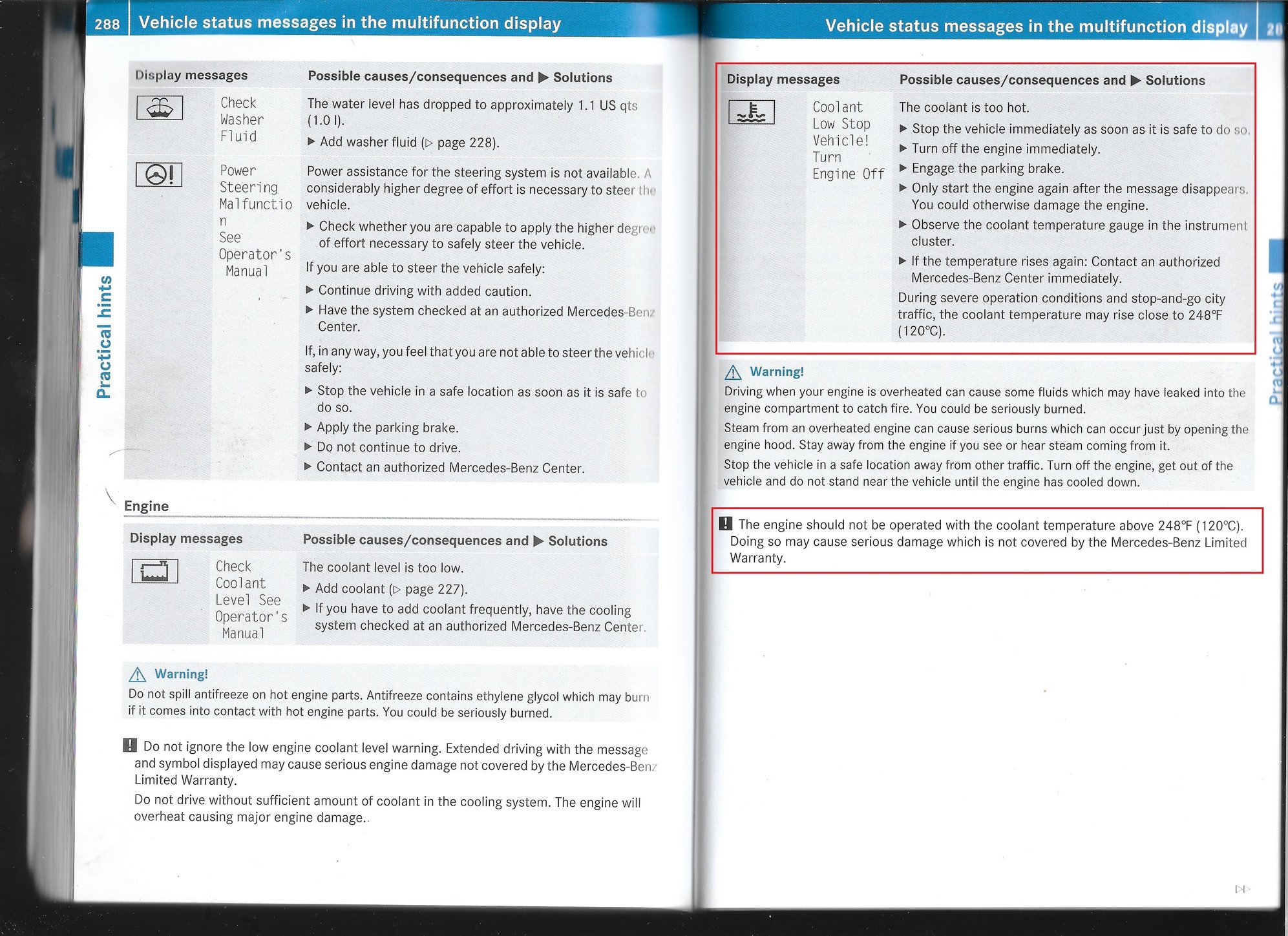

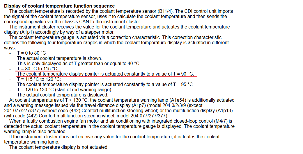

I find it interesting to hear the "normal" operating temp is 110. On my 2010 with M272 engine the temp always hovers at 90 c.
The temp gauge does not show actual temp, typically. According to the literature. I've seen a few threads on this subject.
According to the manual the actual coolant temp is displayed when the coolant is below 80 c and when it above 120 c. See below:
Heres what it shows in my Operators Manual for warnings:
If you say the warning light came on and then the coolant temp gauge appeared to lower i would assume the fan may have kicked on to high.
I would scan the car for any fault codes.
