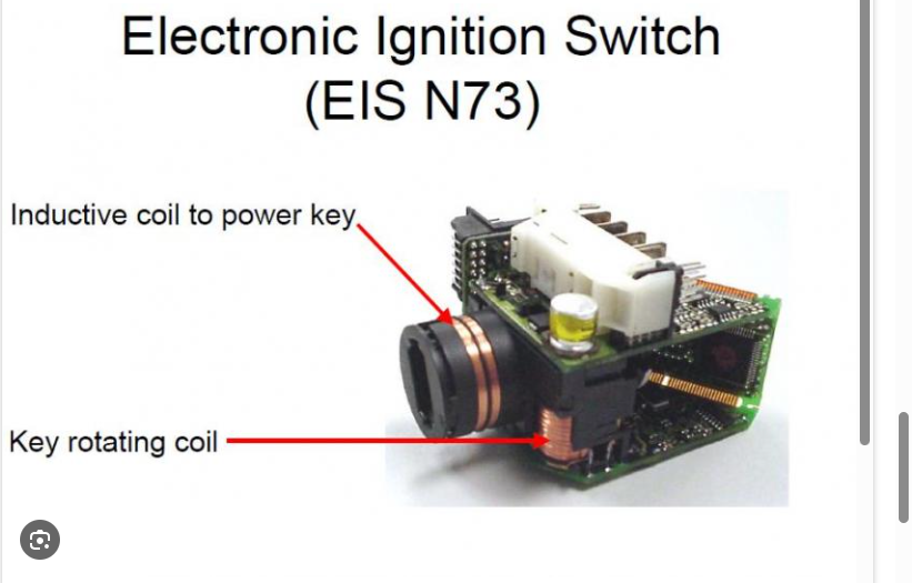

Wonder if there is an issue with the key where the coil has somehow loosened, this can happen when you drop the key on the ground.
They way the key fob works is the battery inside gives power to send signals for the car to unlock, but there is a coil inside the key fob that interacts with the ignition, basically works like a wireless phone charger. The car send energy to the key fob.

Check IR output from key. Selfie cam on iphone will show key tip having purple glow when buttons pushed.
Blow out and clean the EIS where key goes in. Could also be dirty lens or lint in key itself.
The EIS powers it, but then key uses IR to chat with EIS.

You sir are a godsend, literally cleaned out the eis it was dirty and caked up and on my car fires up without a problem and I did not have to waste $300 plus to get it looked at or fixed. Thank you once again good sir.
