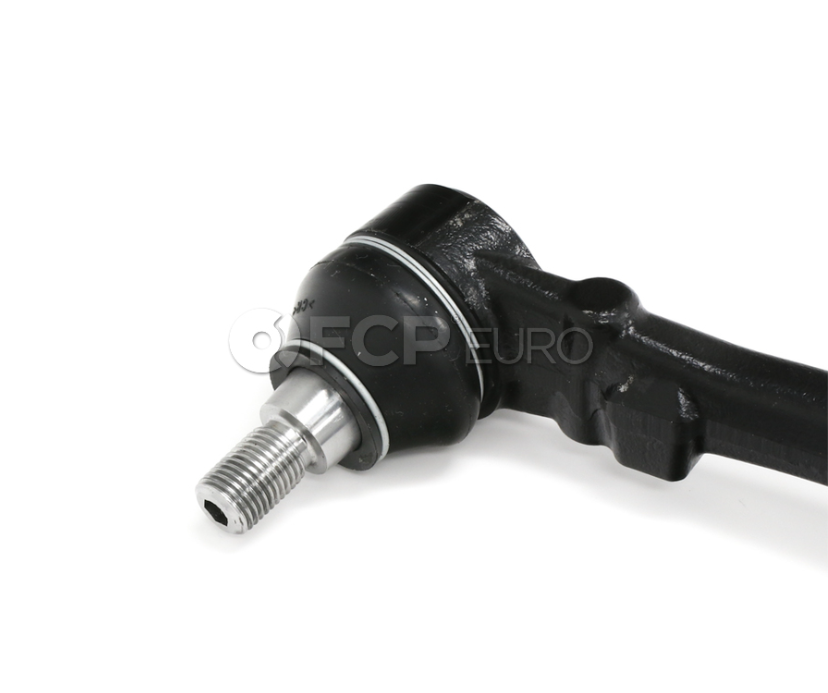

I'm trying to tighten some of these bolt and I couldn't get the torque wrench to click so I started testing it with normal wrench and I don't see the bolt tightening. Am I missing something?
https://vimeo.com/1104817549
use an Allen key in the center of the bolt and a wrench to snug it up tightly and use the torque wrench to finish it off. This is also where a crows foot attachment for a torque wrench can be helpful.

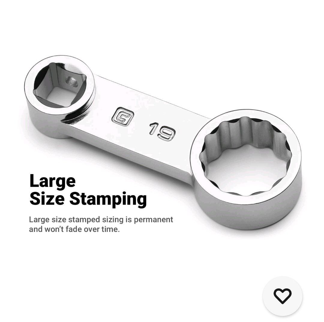

Yeap, the ball joint will spin and spin. Similar to the sway bar links. As already stated have to hold it from spinning. I find torque extensions a good option if you already have a regular type torque wrench. They also come in handy in tight areas like the rear suspension.

Man you are full of knowledge. I need to order one of those. For time being i put the car back together as I really needed it. I hope it's okay for a week of driving without it destroying everything. It's driving okay but i still hear some clanking sounds. I'm wondering if they are from the back wheel. Or could it be something from the front wheels?
Also i should of bought one of those digital torque wrench thing that would beep instead of having 3 different size torque wrenches now and spent the rest of the money on other tools.
