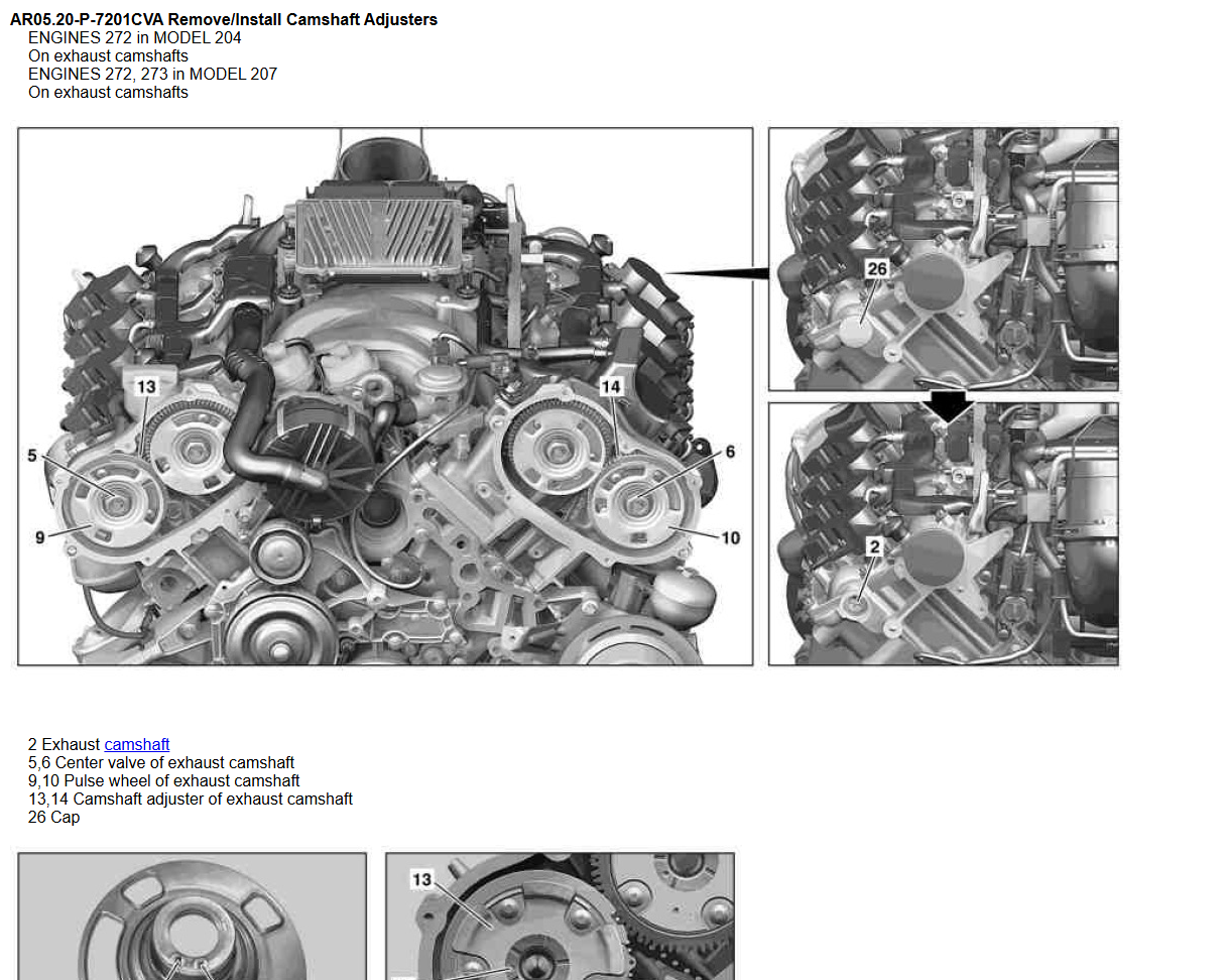

Hi All,
I know there's a video/DIY somewhere for a single cam shafter phaser replacement on a m272 w/o having to take off the front cover....I just cannot find it anywhere. Any leads would be great.

The part shown in the photo?

Yes. I can’t tell if it’s the exhaust or the intake that’s jumping.

I cant imagine replacing them without removing the front cover.

Found the video I was thinking about! If I'm just pulling the phasers, I could likely not have to pull the valve cover. I can also do this without breaking the timing chain....the real question is, should I just go ahead and put a new one in while I'm in there? It's a 111k mile m272 with great service history. Also, this video isn't the great on how to set timing on the two cams, which seems problematic without the cam lock downs.
Any opinions are welcome.
