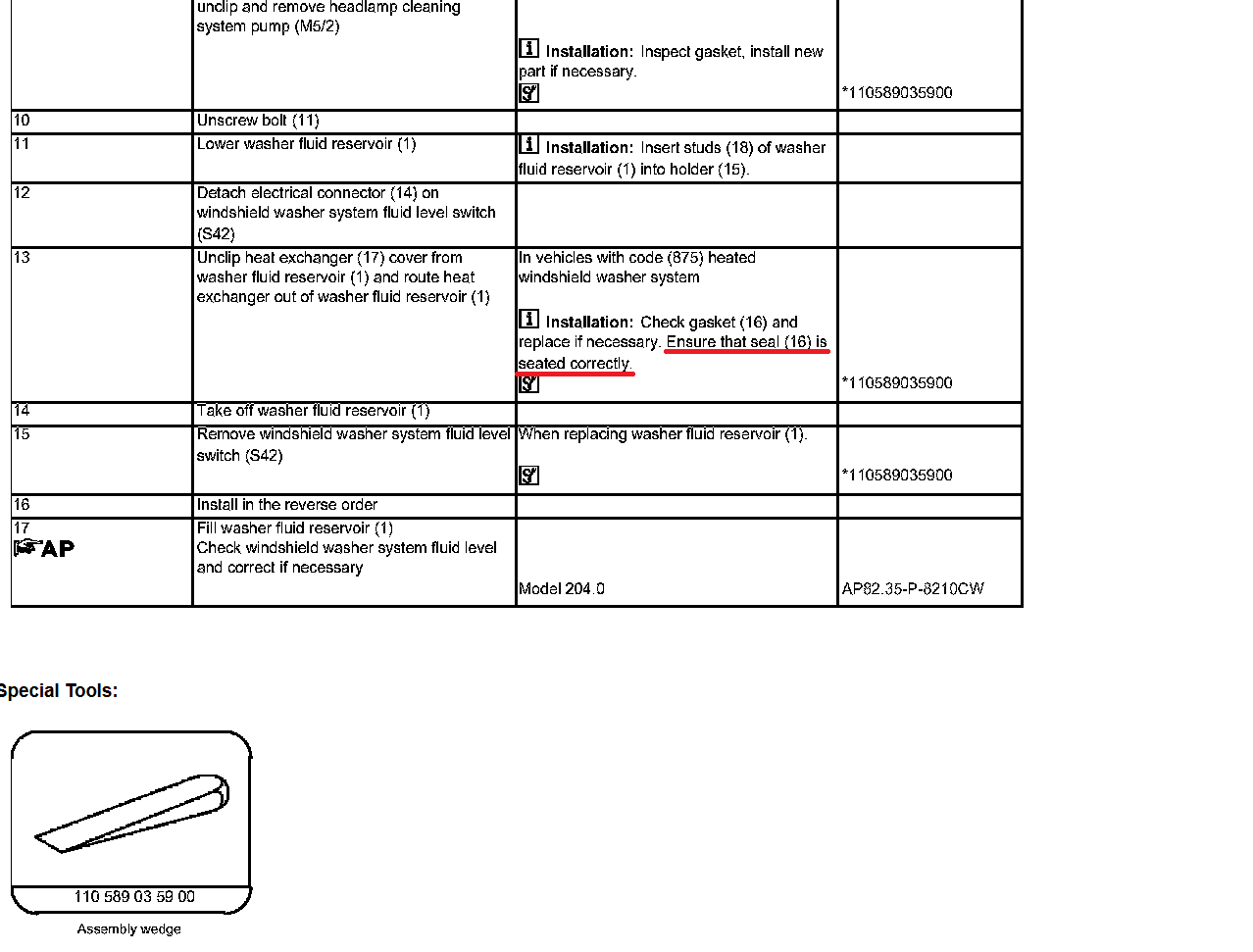

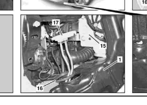

Hey guys I need some help with 2009 C300. Does anyone know the secret to get the Heat Exchanger Cover (A2038690208) that fits on the windshield washer reservoir to snap on or seal? I have tried everything I know of

Have you tried installing the seal first and then install the cover?
