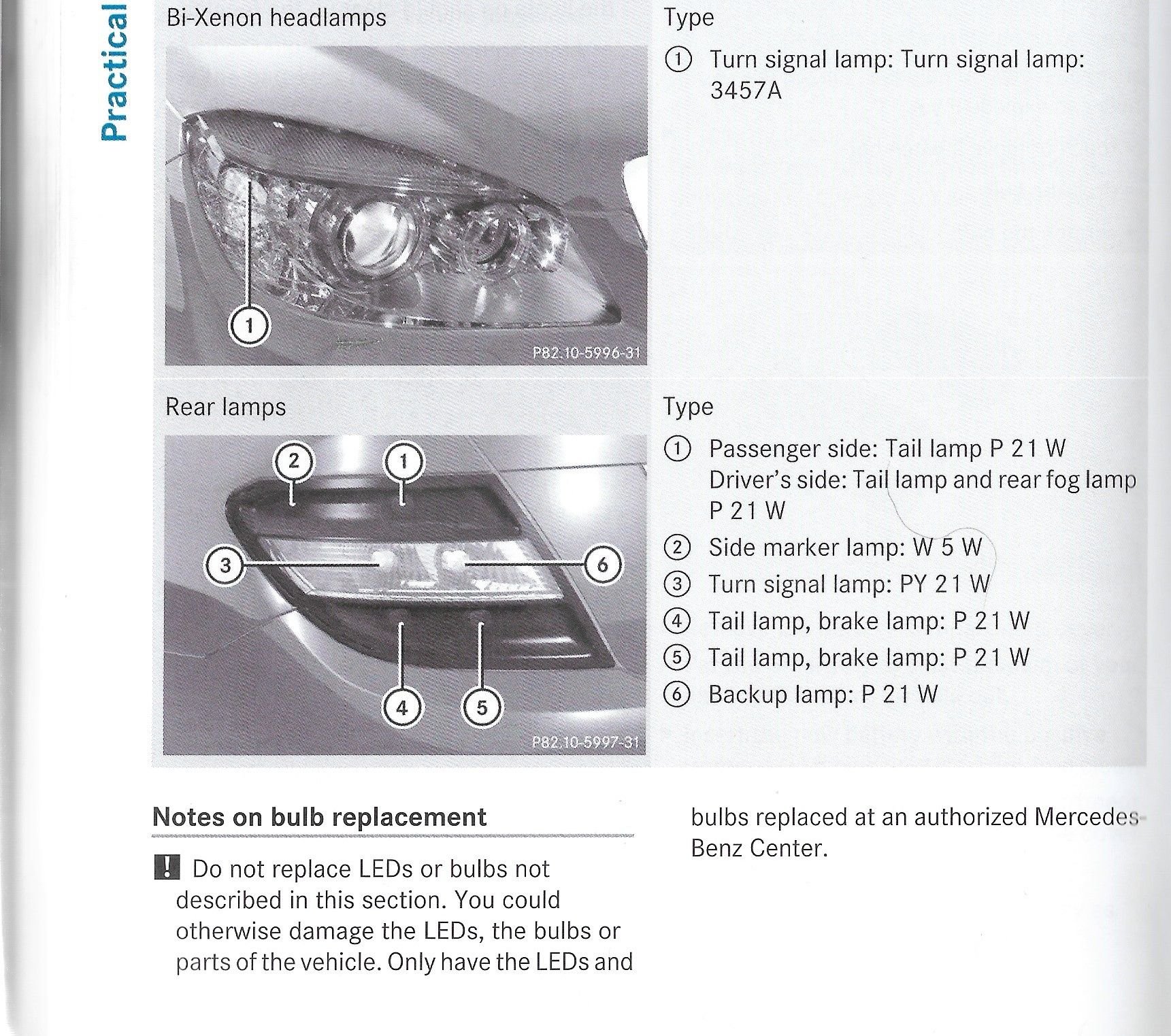

Get out your multimeter and start testing. Since all the other bulbs are working im guessing ground is good. With the bulb out test the holder, which probably wont show voltage. Then test the harness connector, that bulb should be the wire labeled Fog (#4 GRN/WHT) in the wiring diagram. Bulb 1 in the photo of the tail light. See if there is any voltage. If not trace it to the rear sam.
