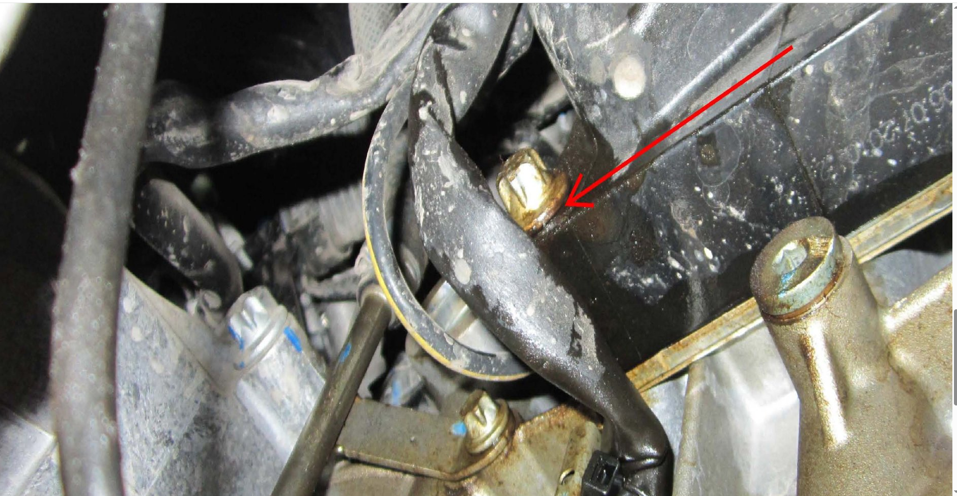

I found a TSB on the oil filter housing and not sure it applies to yours. I'll post it below.
