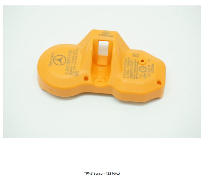

My 2003 W211 used 315 mHz TPMS and my 2010 W204 used 433 mHz. I think the switch over was 2006 - 2009 depending on the model. As mentioned before, TireRack or a Discount Tire store should know the details.
There should be a 433 mHz sensor available to fit the wheel in any case.

I dont think the sensors themselves are interchangeable, wont work with the electronics. Im finding different part #'s between the two. I looked up a W204 sensor on FCP and it does work with many models, even 2002 G500, but does not list 2002 CL500.
On the CL500 parts diagram im seeing part# 0008223306 for the sensor. Seems the same as 0009055705.
But a W204 sensor should fit in a CL500 rim. Same diameter valve stem.
