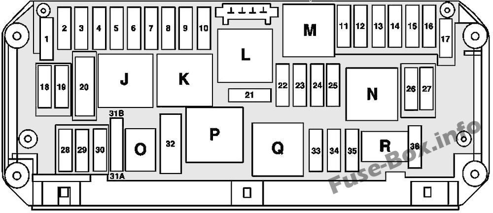

The next step is easy. With key out of the ignition, check fuse number 7. The fuse box is under the hood on the driver side back corner of the engine compartment.
The starter relay is labeled M.
The fuse doesn’t usually blow unless something else is wrong, but it’s easy to check.
Let us know your progress.

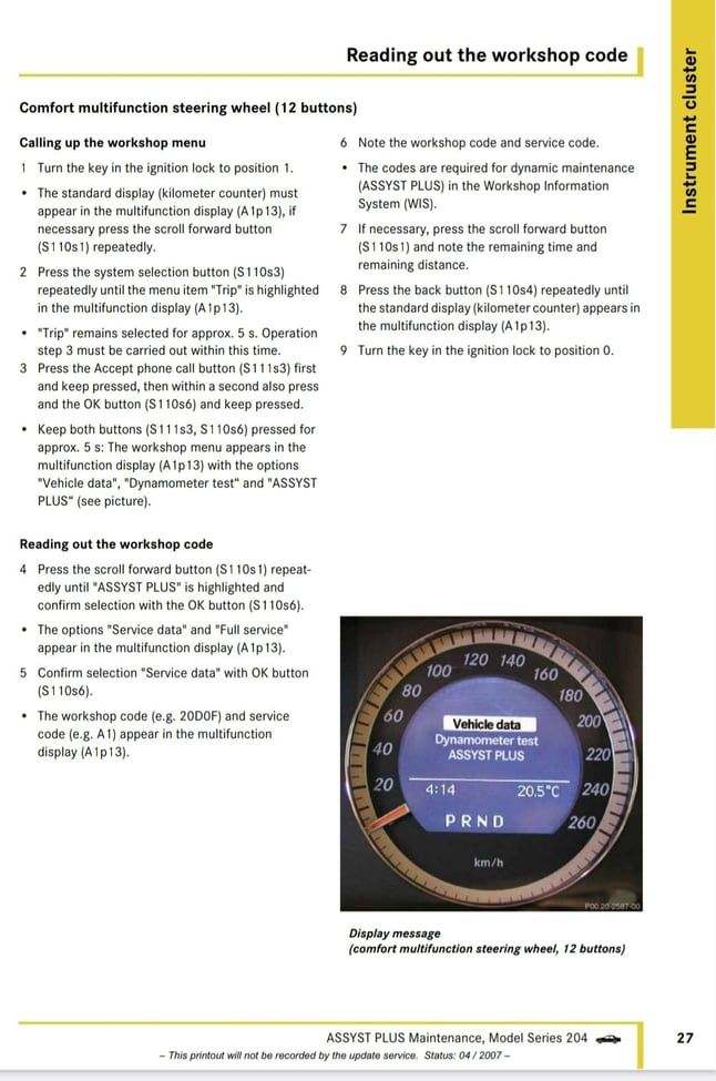

If you dont have a multimeter handy to check the battery voltage you can look it up on the dash using the steering wheel buttons.
Follow the instructions for calling up the workshop menu below. Dont bother with the reading out of workshop code. You should see what is pictured in the photo on your dash. Click on Vehicle data and you should see a menu for voltage.
