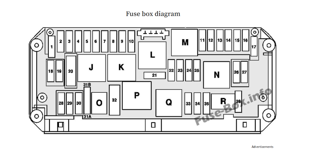

With your vin you can look up your build sheet and see what options you have for lighting. 614 is for Bi-xenon headlamps. Or just open the covers on the back of the headlight housings and look. there is also a sticker label on each housing, if you look down at the housing next to the hood latches you can probably see it. It will list all the bulbs in the housing.
The fuses in the front sam that deal with the headlamps are fuse 14, 29 and 30 depending on your model. If im checking fuses I will check them all while im in there, simple with a multimeter. Heres a link to the fuse diagrams: https://fuse-box.info/mercedes-benz/...uses-and-relay
You can always test for voltage at the harness where it connects to the headlight housing.
Heres a link to the 2007 W204 manual with diagrams. Not your exact submodel but should be the same or similar. Lighting and Horns > Diagrams: https://charm.li/Mercedes%20Benz/200...orns/Diagrams/

I tested all the fuses with a multimeter and all were working fine. So that is not the problem. After looking at the bulbs I've seen that they're both Xenon (Both Low-Beams (Dipped) and the High-Beams).
Should I just take it into the shop for a diagnosis?
