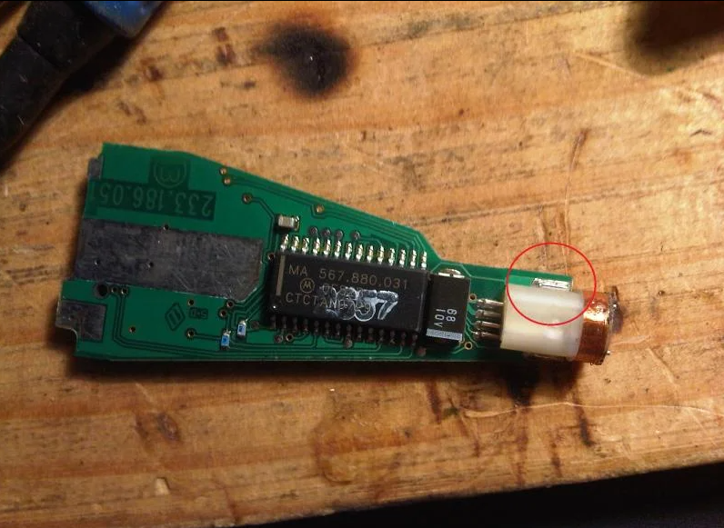

Do you have two key fobs to try?
When you insert the key does a message on the dash come up?
Does the steering wheel unlock, can you turn it?
Have you inspected the key fob itself, look for cracked solder joints at the coil?
A new/used EIS will have to be programmed.
