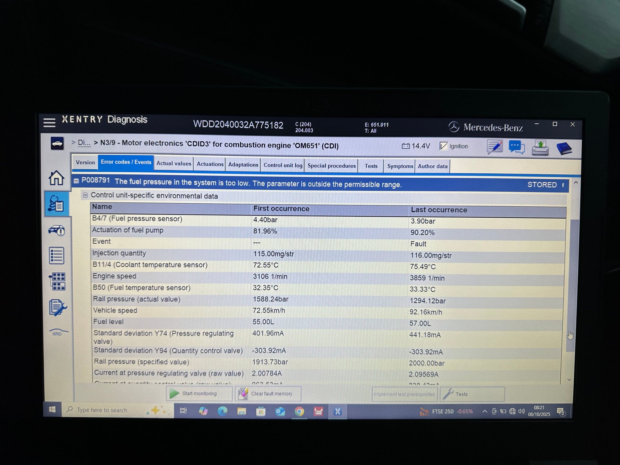

  • After my first Stage 1 remap at JACustomTuning, I started occasionally seeing P0087 (Fuel Rail/System Pressure Too Low Bank 1) under WOT. At that time, there was no smoke at all.

  • P0087 – Fuel Rail/System Pressure Too Low (intermittent)

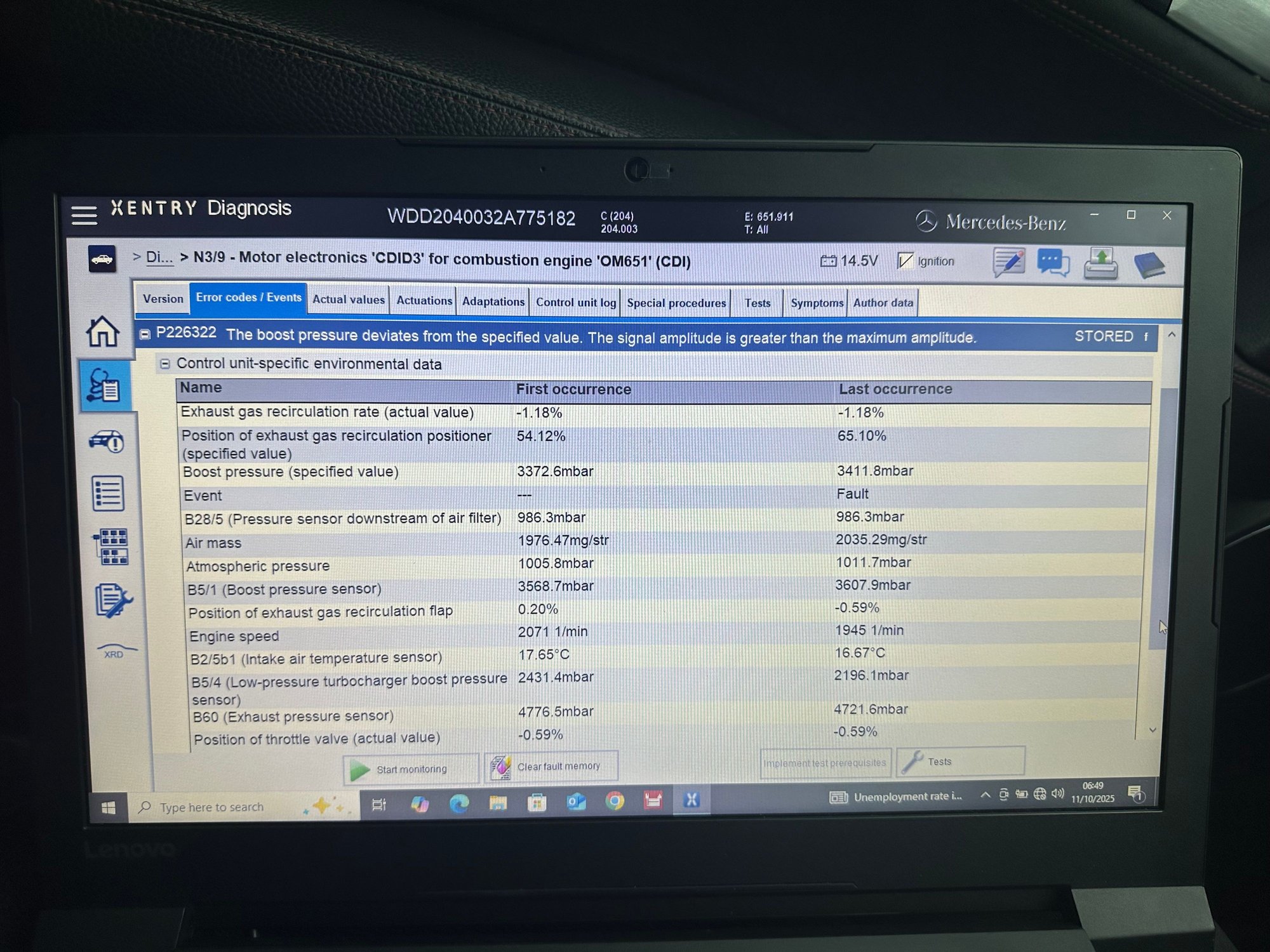

  • P226322 – The boost pressure deviates from the specified value. The signal amplitude is greater than the maximum amplitude.
    • Note: This occurs mainly from kickdown off the line, typically in 1st or 2nd gear at WOT.
    • In other WOT pulls (e.g. rolling acceleration), I only ever get P0087, not P226322.

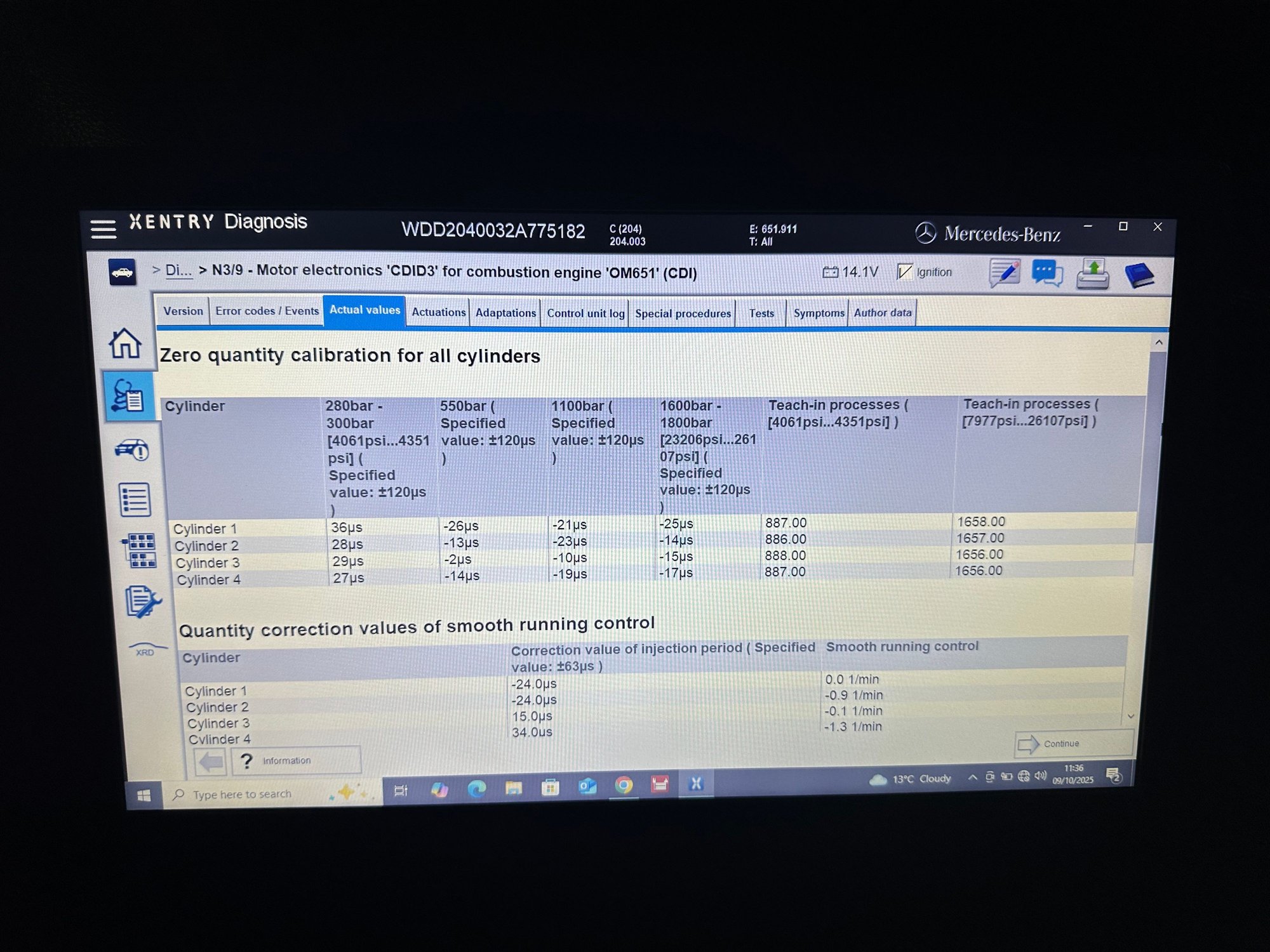

  • Injectors tested by Colchester Diesel Injection – all reported fine, not replaced

  • Fuel rail + Y74 pressure sensor/regulator (used & new) – no change
  • HPFP replaced with a used one – no change
  • Xentry tests for fuel delivery, boost leaks, Y74/Y94 all pass
  • Replaced Y74 after it fell out of spec on Xentry test – fixed test result but no change to smoke

  • P226322 only appears during kickdown in 1st/2nd gear, otherwise it’s just P0087

  • Any suggestions for specific live data to log or further tests that could help narrow it down?
