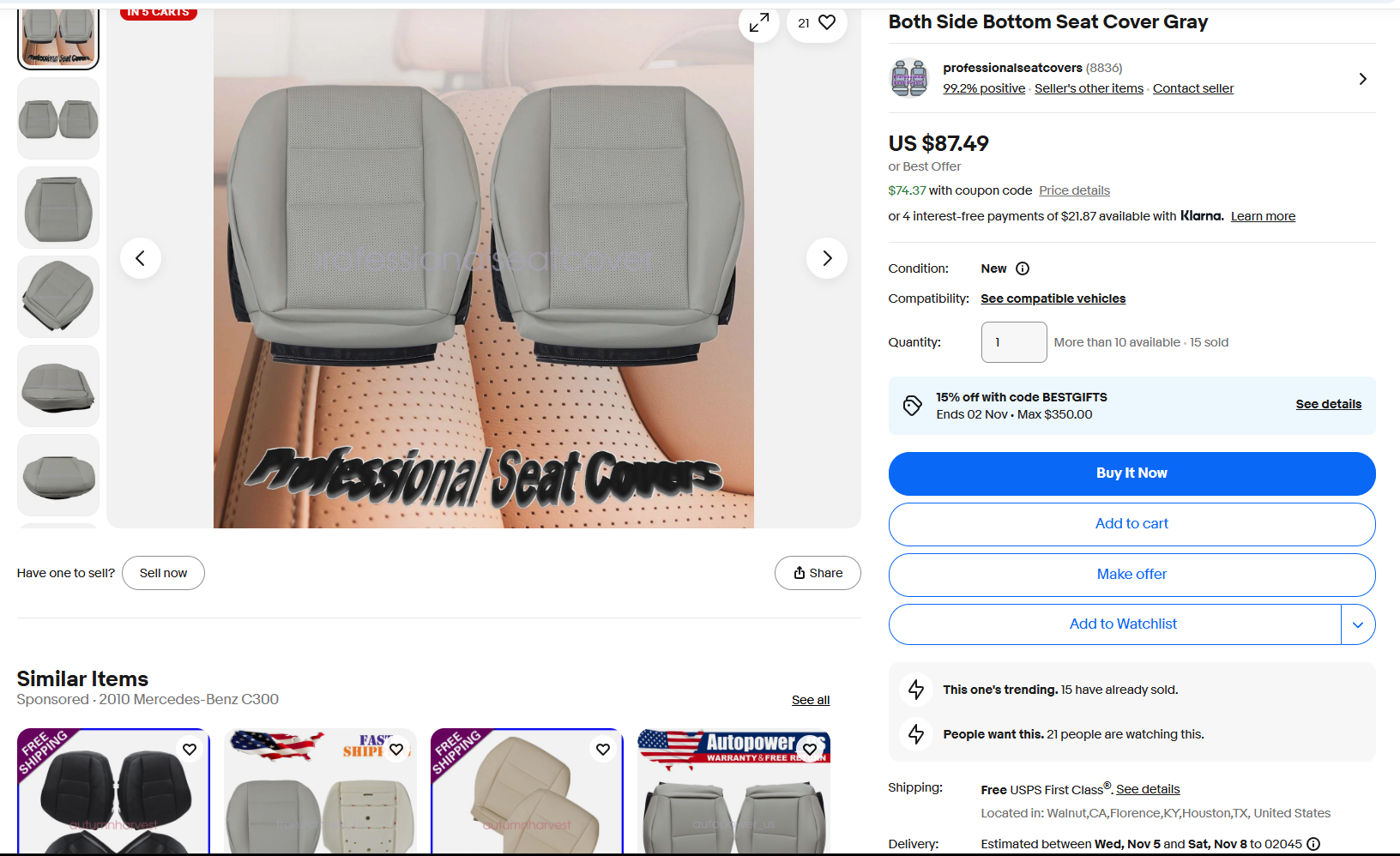

My 2010 W204 drivers seat started ripping last winter and its just been getting worse. I really dont care since and can live with it since maintenance on this car is never ending and other things to spend money on. I am worried it will keep getting worse and maybe ruin the cushion underneath and maybe mess up the heating function, I do love heated seats in winter. I always search around on eBay and come across used seats for around $100 but worried its just going to rip since they are all around the same age.
Came across a listing for two seat covers for $74 or one cover for only $34. Decided to order one and see how it looks. There is one review with a photo for the cover and it looks good to me.
Figured I would document how it turns out. The cover should be delivered tomorrow so will update. It wont take alot to make me happy.
The review in the last photo is not from me.

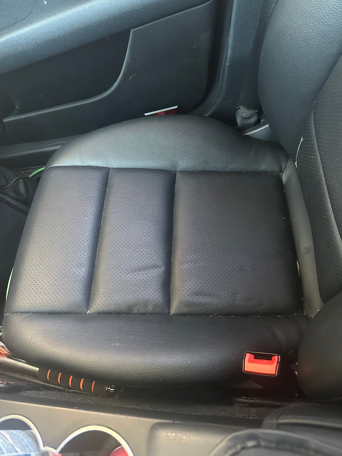

Received it in the mail today. When I opened the package and saw it i was disappointed because it looks like a darker grey color as opposed to a lighter grey. But then went out to the car to compare and I really cant tell if i like it or not. The color changes with the lighting. I dont want to open it just yet in case i want to try to return it. Its vacuum packed so its folded and wrinkled.

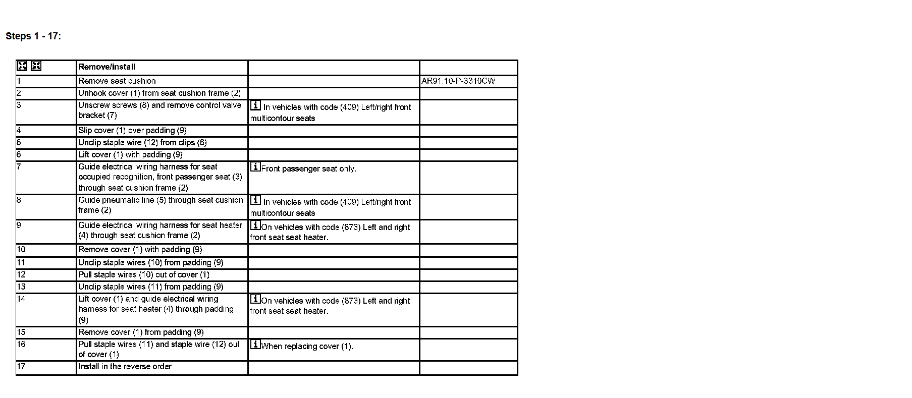

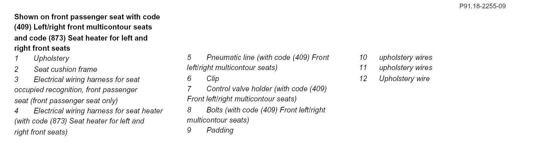

Found some instructions:

I still havent even removed the new cover from the package yet. Since im seeing wrinkles I plan on spending some time trying to iron it the best I can. Im guessing low setting on the iron would be safest.

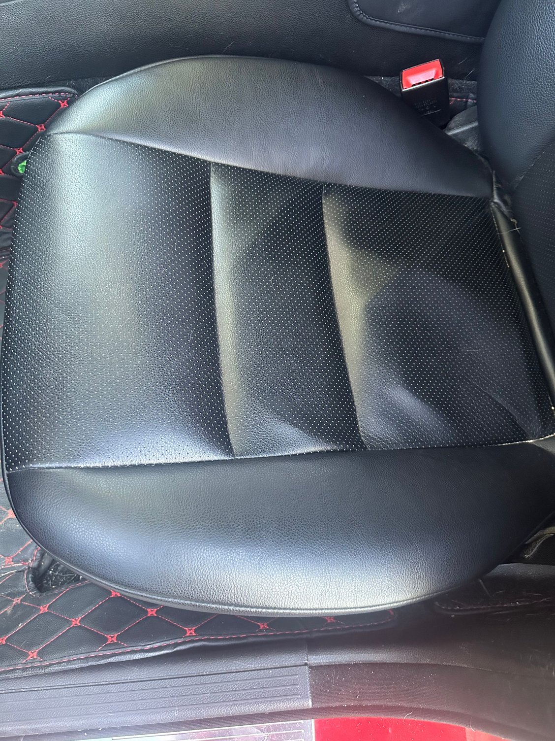

Yeah the wrinkles are real but expected for a folded up cover. And I didn't expect a perfect fit for the small price I paid. The heater is the only pain about the whole job both the element and it's plug. But I'm not saying that was hard but the hardest part IMO.
This is the driver's seat knock off that I didn't get the creases out from being folded up. But I'm always sitting on it 😁

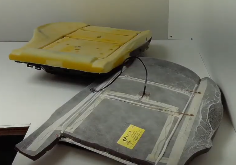

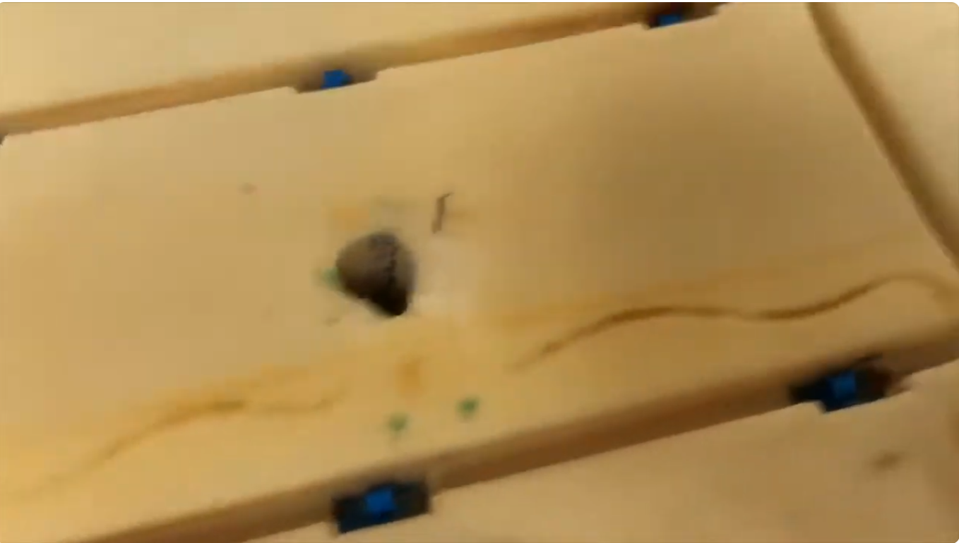

I watched a few videos on replacing the seat cover and most are installing a Genuine MB replacement cover so does me no good. Came across one videowhere the person doesnt even bother reinstalling the heated pad so thats useless. Watched a video from Richmond Auto Upholstery and while it shows what the original heated cover looks like and it explains how to install there cover it doesnt show much and im left with questions.
Heres the video I watched:

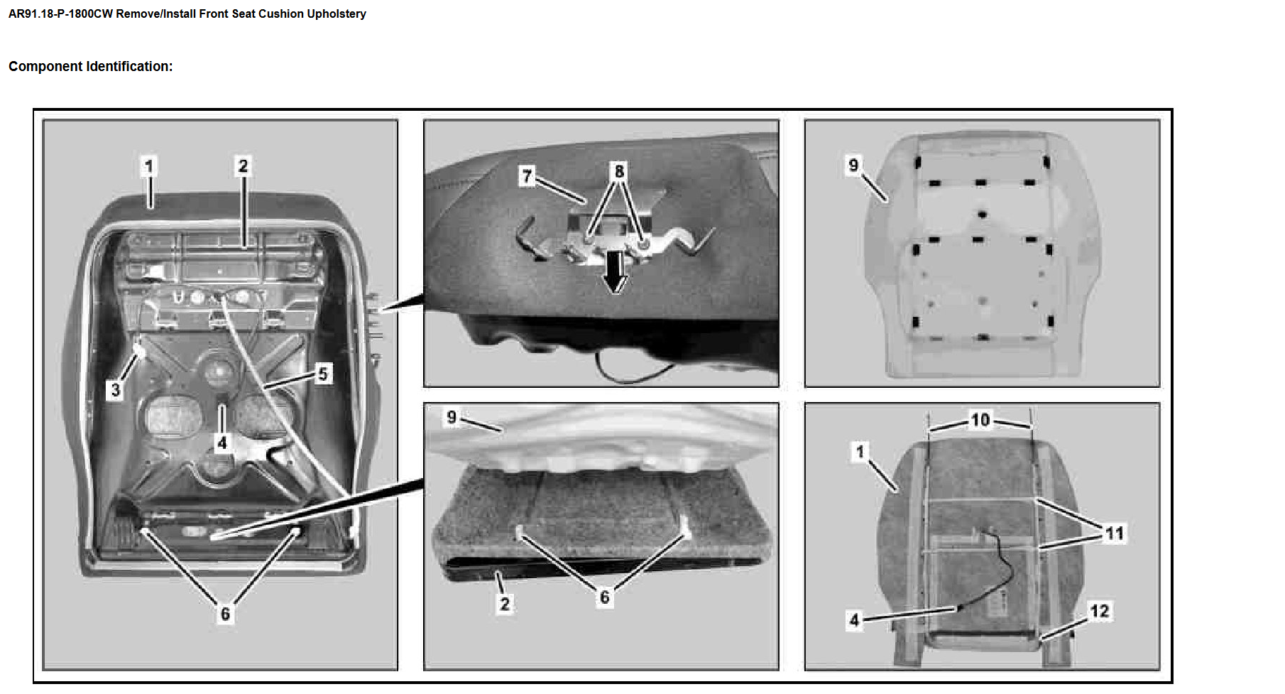

In the original MB seat the heating element seems sown/installed in the padding. The padding seems easy enough to remove from the cover. Then sown onto the bottom of the padding is a cloth sleeve that has a wire going thru, this wire is what clips down onto the base of the seat.
Looks like they expect you to make slices in the original heated padding to be able to fit the new covers plastic sleeves that clip to the base of the seat. They say make full slices in the pad for the two vertical side sleeves, but for the horizontal sleeves just make small slits in the pad where the clips are located.
From the comments in the video it seems people have done it and the heating still worked afterwards. My question is how does this effect the heating element, im sure slicing thru the padding results in some of the wiring cut.
Im floating the idea of cutting off the sleeves on the new cover (blue part in photo) and only leaving it where the clips in the base are located. That way I can make small slits in the heated padding, stick the small sections of the sleeves thru and clip to the bottom that way.
Screenshots from that video. Shows the white cloth sleeves with wires inserted used to clip to the bottom of the seat.
Screenshot of the bottom of the seat showing the blue clips.
Instead of the wires the new cover has blue plastic strips that are supposed to clip to the bottom.
Wondering if it will work if I cut away most of the plastic strips and leave it just where the clips are located on the bottom of the seat. Can make small slits in the heated pad instead of long slices.

I think im wrong in my original thoughts about the heating element. I can see the wires for the heating under all the taped areas but I also thought there were additional heating wires imbedded in the padding that I cant see. because when I search for heating pads for heated seats im seeing pads with alot of wires zig zagging everywhere. Is that all there is for the heating in these seats, just the wires under the tape?
Now im thinking i can just peel off the tape to remove the wires off the pad, slide the pad accordingly for the new cover, then make some slices in the middle sleeve part to fish the wise back thru and tape down.
Wonder if i can install the wires on the cover instead then put the padding on top?
