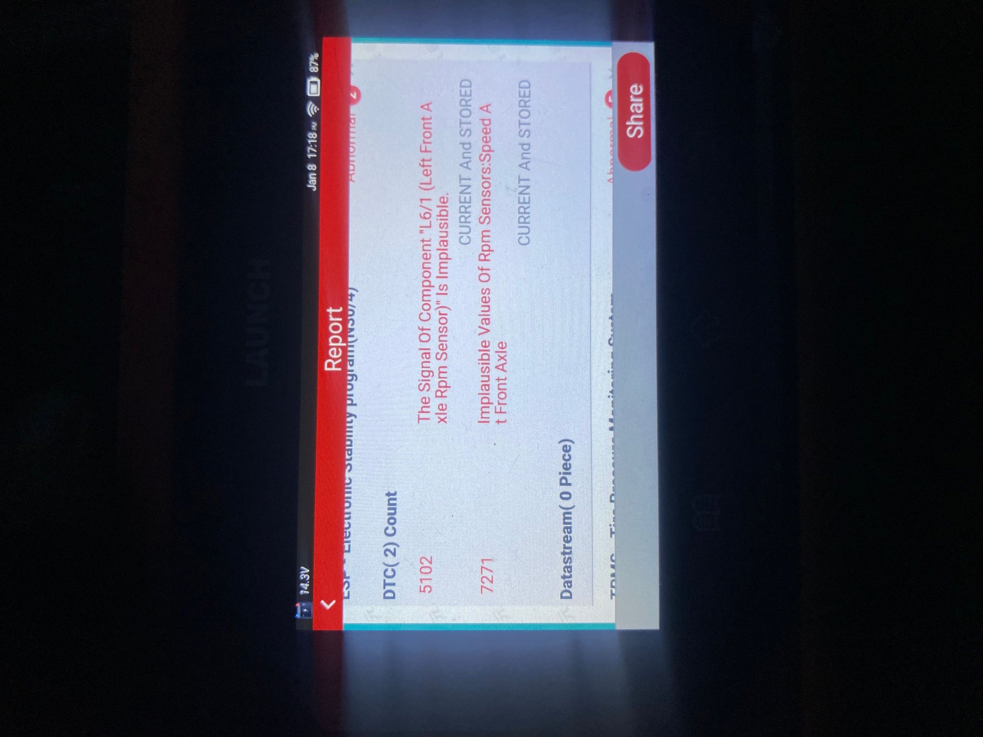

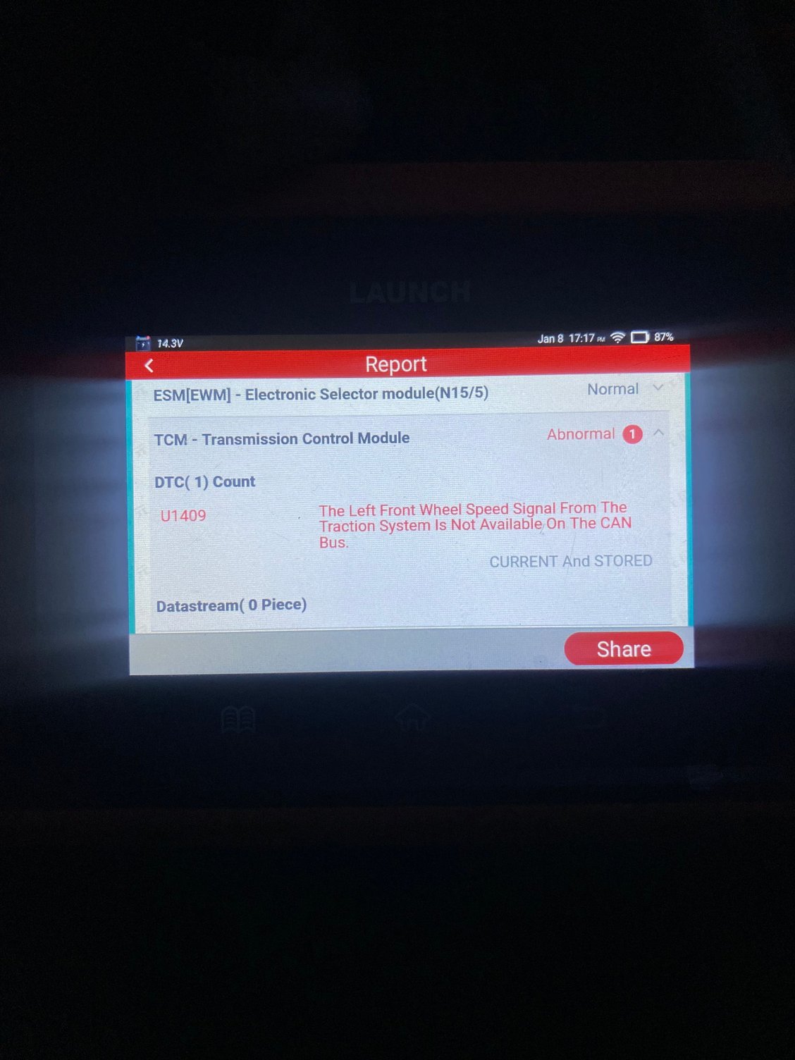

I replaced the left wheel speed sensor with OEM merc part and this code came up again. I don’t know what’s causing the issue , maybe faulty fuse? Any recommendation on things I should check?

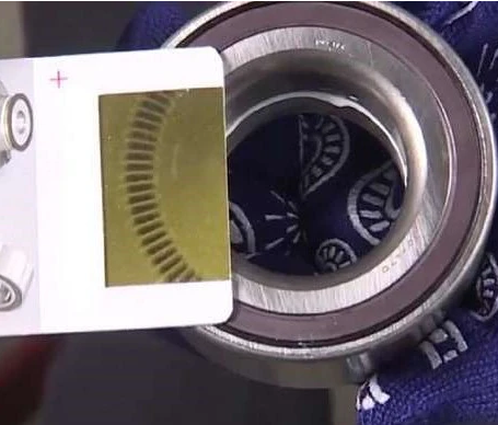

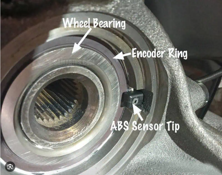

On the 4matic the magnetic rings are in the wheel bearings. Have to replace the bearing, if that is the issue.

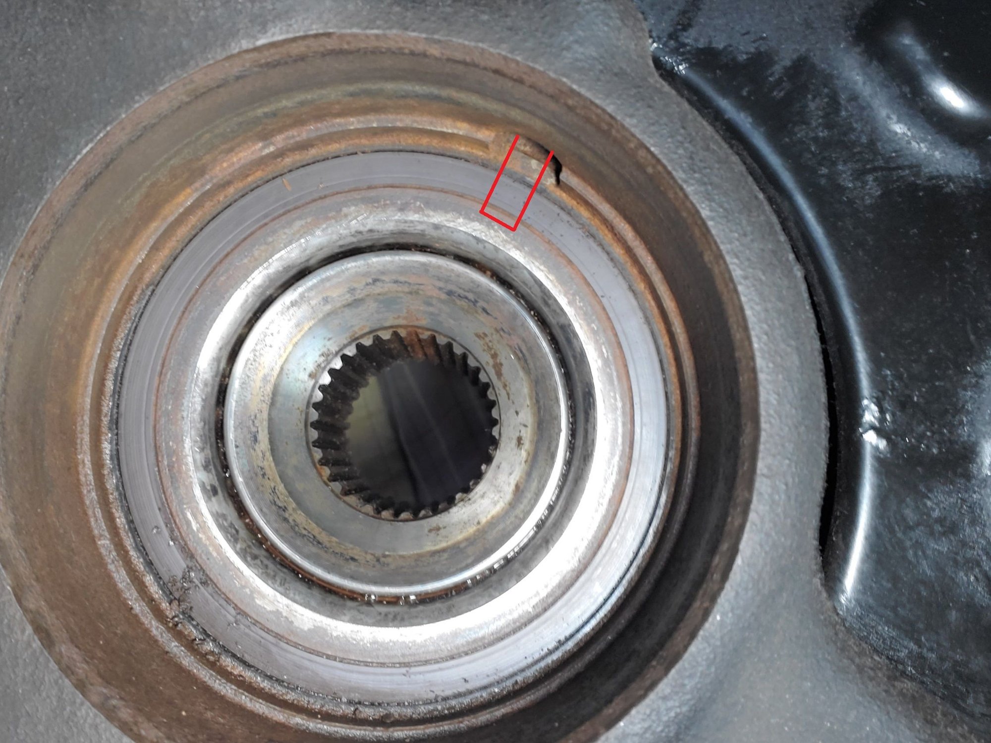

Photo below is what it looks like in the wheel carrier. Red lines indicate where the wheel speed sensor sticks down. Gets its readings off the surface of the wheel bearing. This was taken when I worked on my cv axles. Can see bits of rust that collects in there. That may be an issue.
yes OE sensor , sorry. Genuine Mercedes part. Yes replaced and cleared codes , codes came back. Oh so I can’t just single change the ABS ring , I have to change the whole bearing ? Damn I rlly thought I could just change the ABS ring . How can I clean it properly , I want to test if I could before I change the whole bearing itself

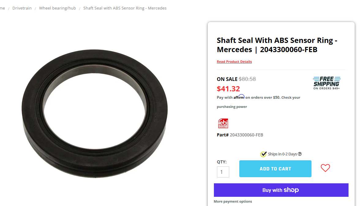

On RWD models the abs ring is in the sealing ring:
On the 4matic it is in the wheel bearing. This is common on other 4-wheel drive vehicles:

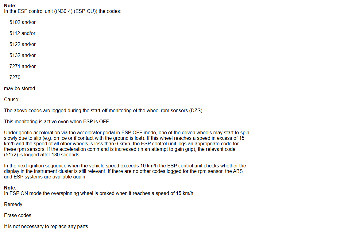

In the fault codes im focusing on the word "implausible". Which to me means the readings arent within spec/what the car thinks it should be but its still seeing a reading. I have never personally working on abs issues other than simply removing/reinstalling the sensor which working on the axles.

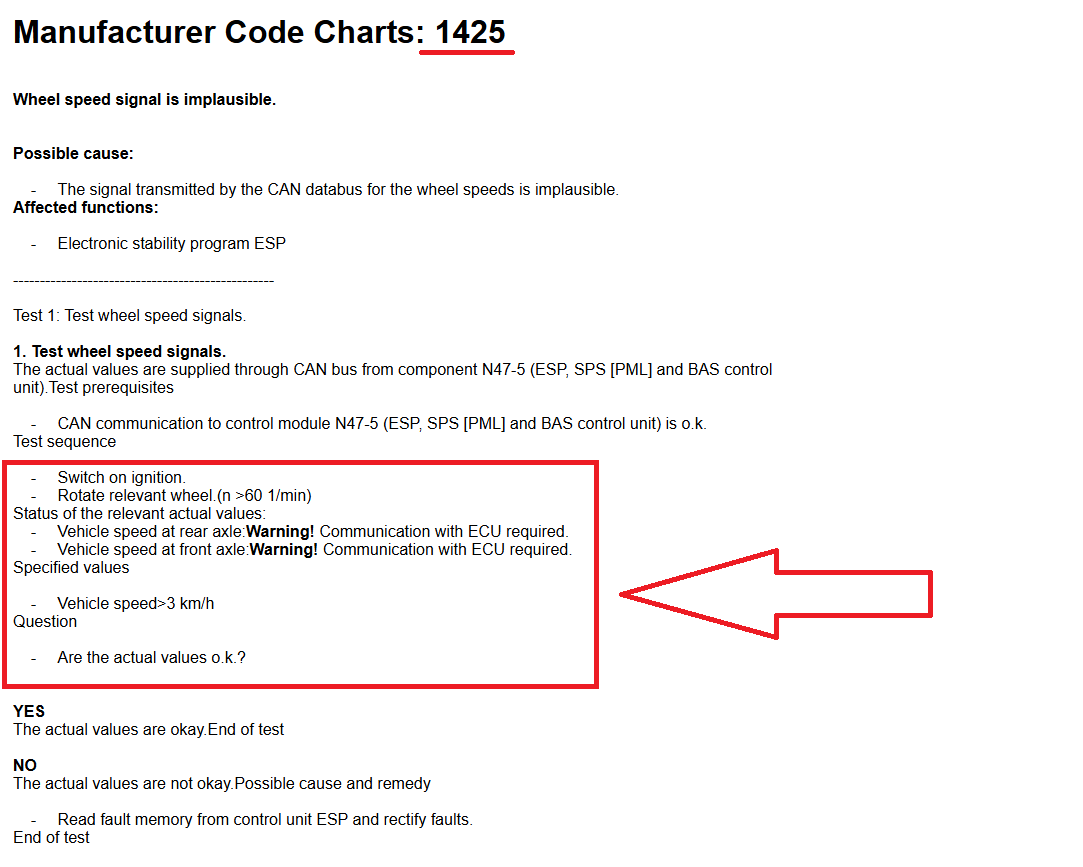

Lets see what we can find on those specific fault codes:

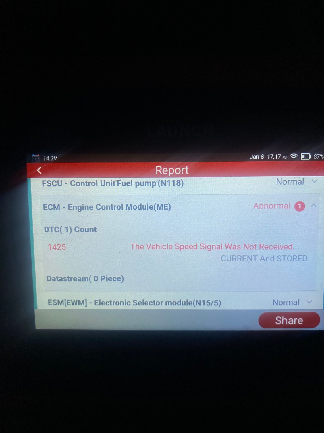

Not finding much. I would start by using your scanner to see what that wheel speed sensor is reading, if anything. Have you checked to see if is at least functioning, showing any speed? Even though your scanner is showing "signal was not received" the specific fault code in the manual is saying "implausible".

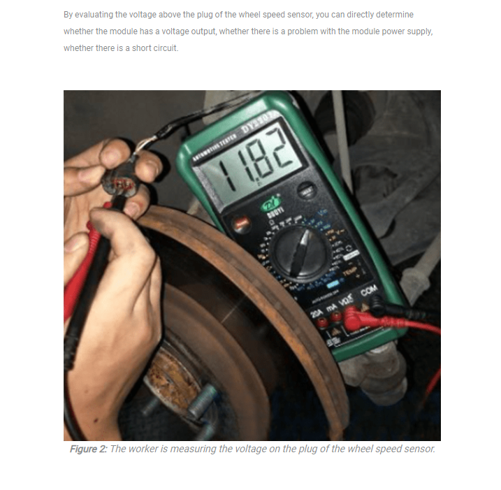

I never did it but I have seen ways to test the sensor itself. Use a multimeter and connect it to the sensor connector, rotate the hub and see if you see any readings. It will be low voltage.
I have checked the sensor , it says it’s connected and giving volts . So I think there’s no issue with the sensor . It’s just not reading the speed , which makes me think if it’s blocked or dirty or cracked . I have bought a new speed sensor and the codes went away for a week and then it comes back . Nd now I’m thinking if I have a cracked ABS ring or a faulty fuse .

I can replace just the bearing correct? Or would I have to replace bearing and hub ?
