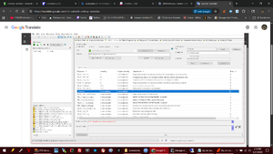

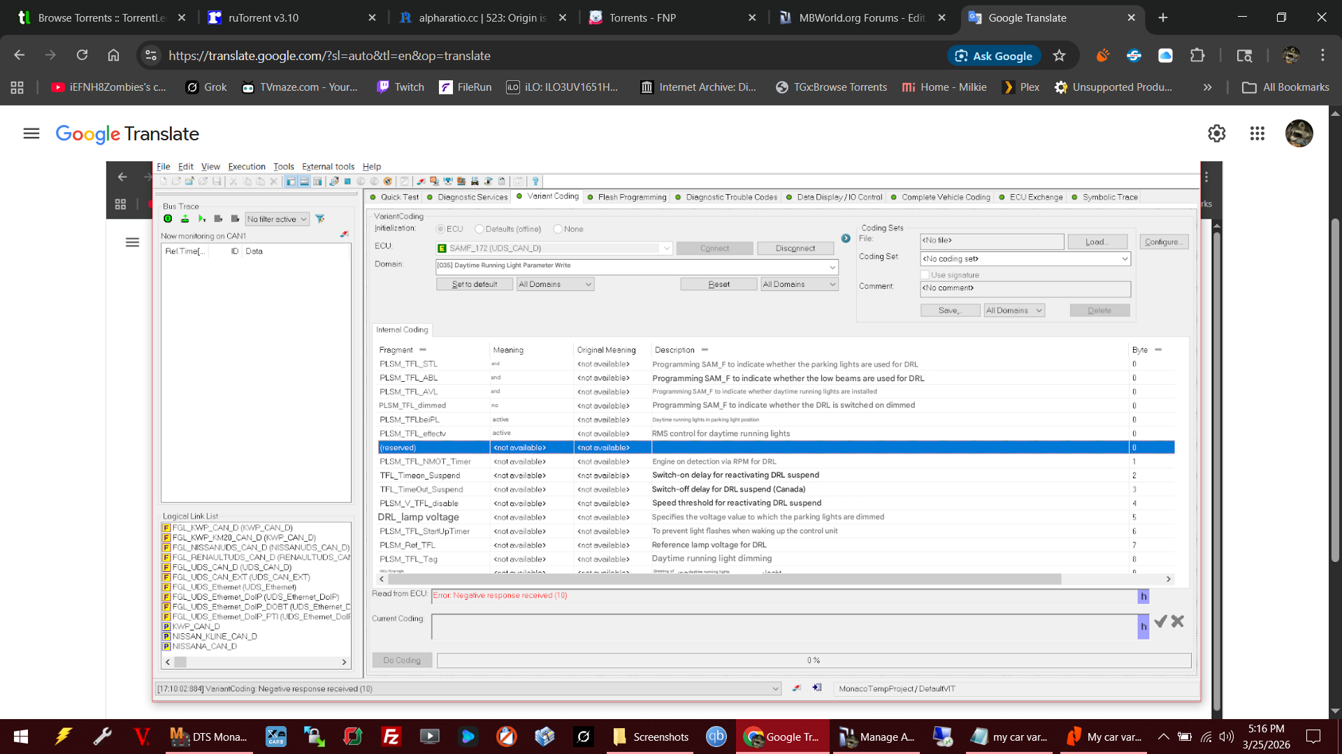

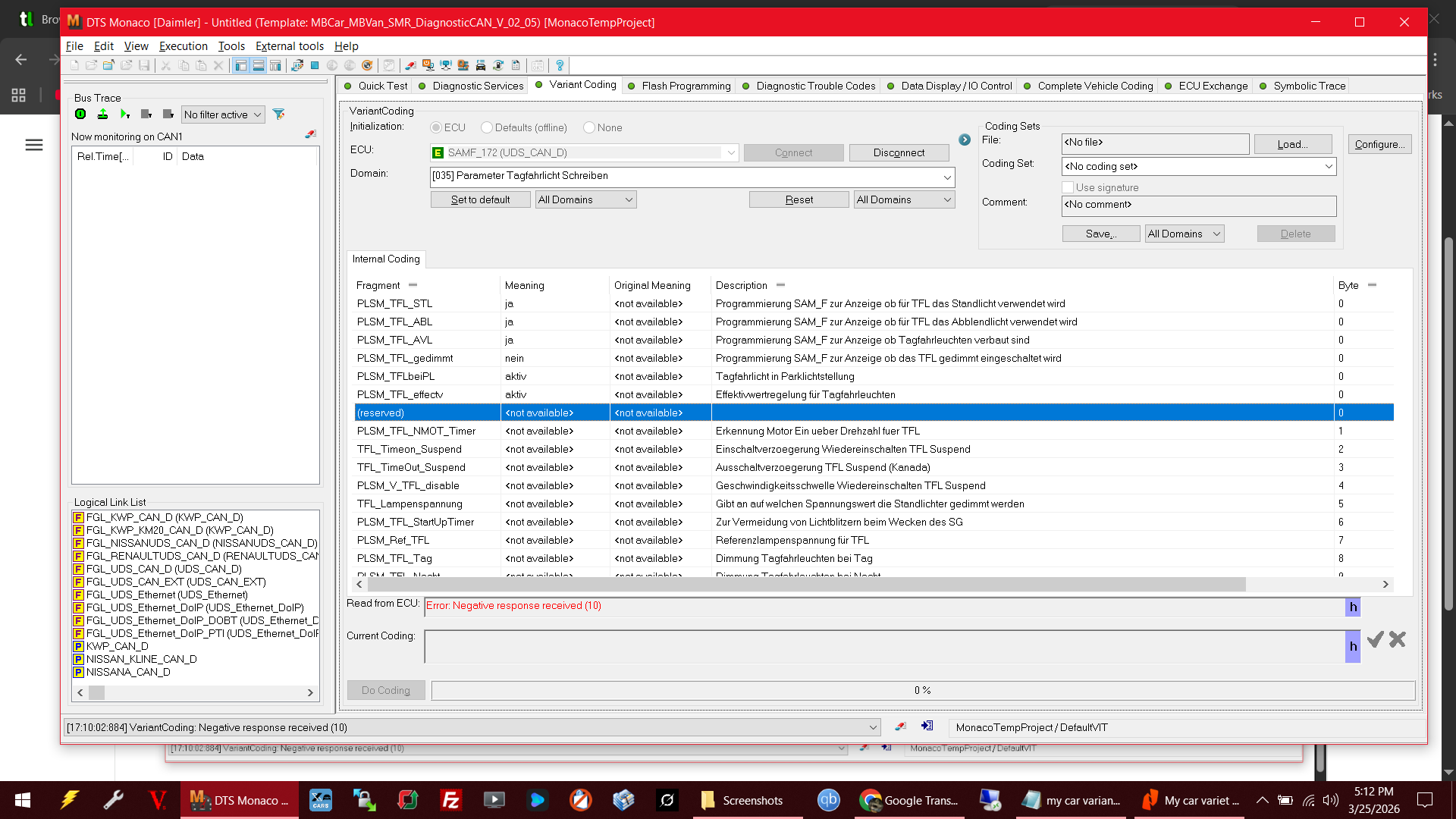

Do you have the software to connect to the front sam on your car? You would need DTS monico or videamo to change the settings.
Here's two screenshots of the place to go in the from sam and the DRL options.
Attached Thumbnails DRL Coding-screenshot-303-.png   DRL Coding-screenshot-304-.png
