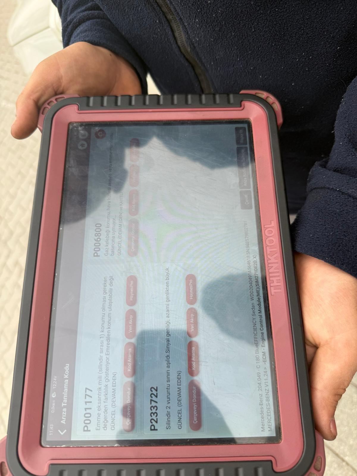

I have also attached a photo of the error code for reference.
At this point, I’m not sure if the issue is related to oil pressure, timing system tolerances, or sensors.
Has anyone experienced a similar issue or can suggest what to check next?
Thanks in advance.
Error Codes: P006800,P001177,P233722

The trouble codes point to 3 distinctly different failures, which you have probably seen on your scanner descriptions.
-Mismatch in information received from air flow and throttle position sensors
-Camshaft timing errors
-Combustion knock sensor cylinder 2
Since increasing idle speed remedies errors and the throttle body is new, possibly the MAP (MAF?) sensor is at fault.

For the fault codes I come up with intake cam position off, implausible air mass to throttle valve and self adjustment of mixture erratic?
If the fault is for the intake cam can you see its position on your scanner? Reading upon start up then at idle.
