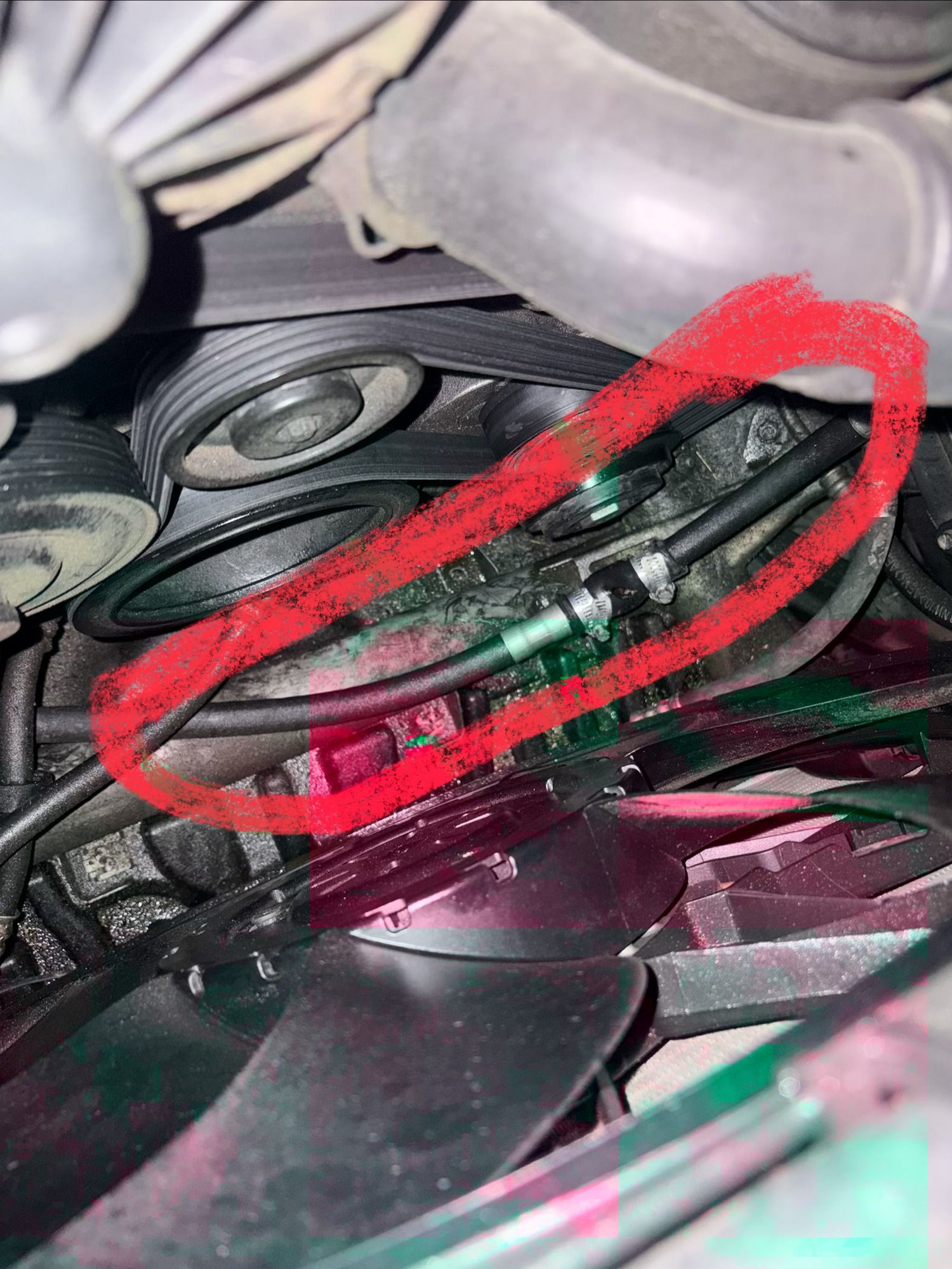

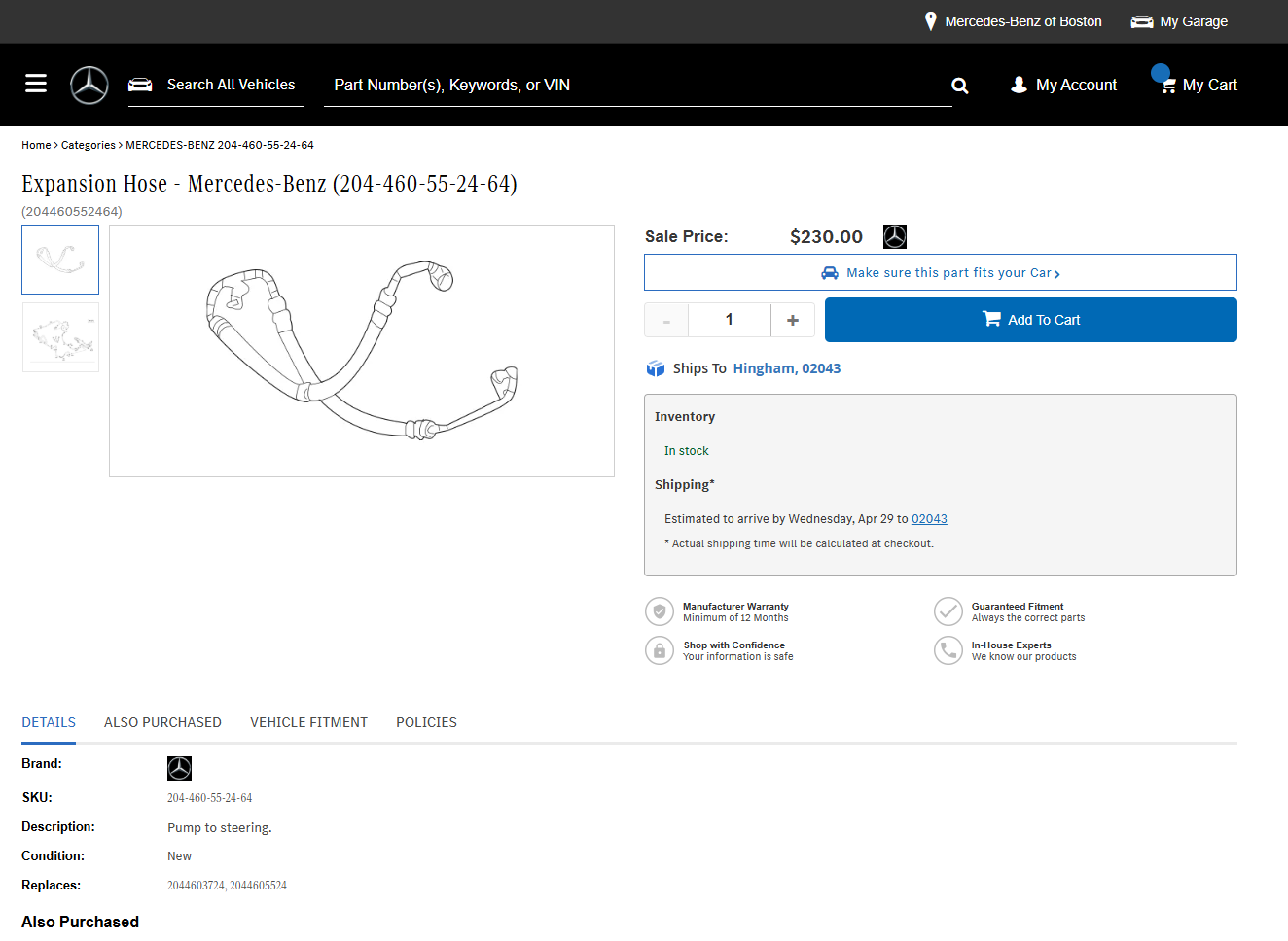

So my girlfriend got her first car🥳. Though it is leaking power steering fluid. Im trying to figure out the issue and saw this line and believe it is the issue. Id just like to make sure it is and if anyone knows the part name that would be amazing. Thank you

Year, submodel and engine would be helpful.
VIN # also.
looks like its the M272 engine?
There are a few different part #'s for the hose so not sure which specific one that is.

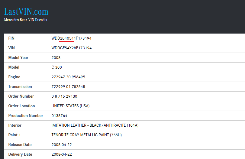

Hey so the vin is WDDGF54X28F173194. It is a 2008 Mercedes C300 V6. That looks like the right part though. Thank you for the help so far.

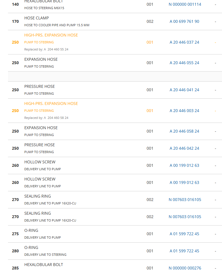

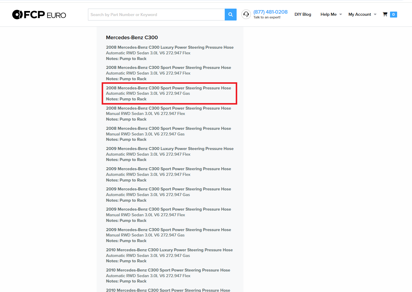

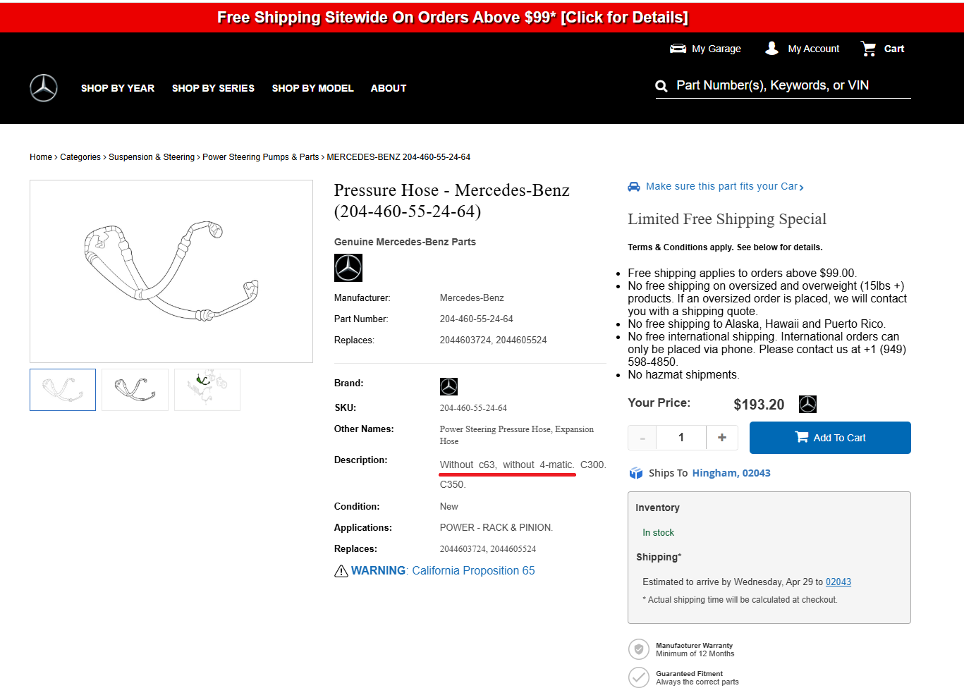

From the vin you have the 204.054. RWD C300 Sport. Option code 486 sports suspension with 772 AMG styling package.
The correct part# for that car is 204460552464. Its the updated part#.
