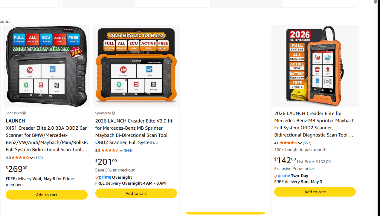

I recommend to everyone they get a Mercedes specific obd scanner. I have saved alot of money using mine to diagnose problems with the car. Can get a Launch scanner for $100.
Steering wheel unlocking is a good signs.

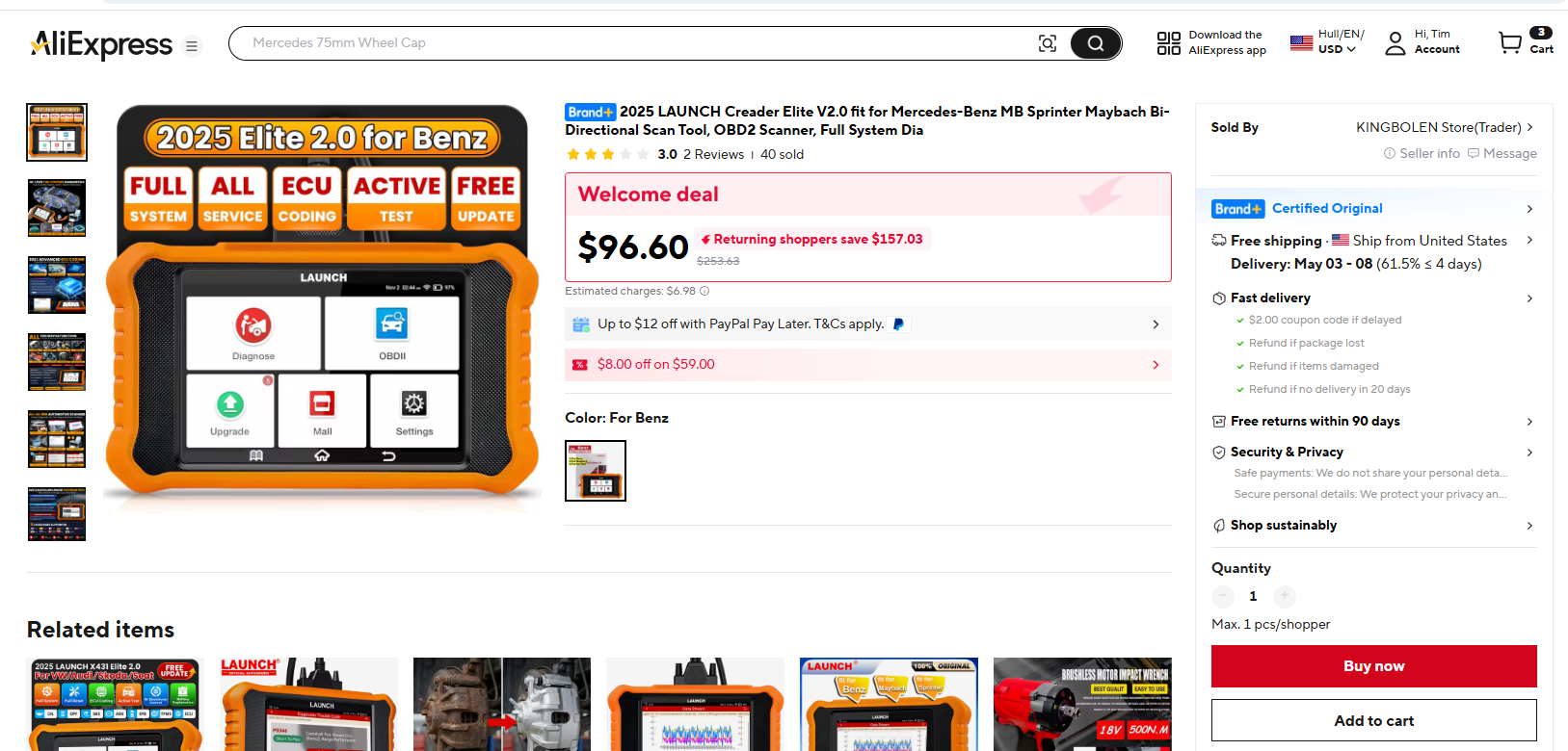

Use a mulitmeter and check battery voltage at the battery posts when the engine is running, should be 13.5v or higher. If it's not then the alternator isn't working.
if you dont already have one get an obd scan tool like the Launch creader. $100 on AliiExpress. It should tell you if there's a fault with the alternator or charging system. And help figure out the rough idle.
