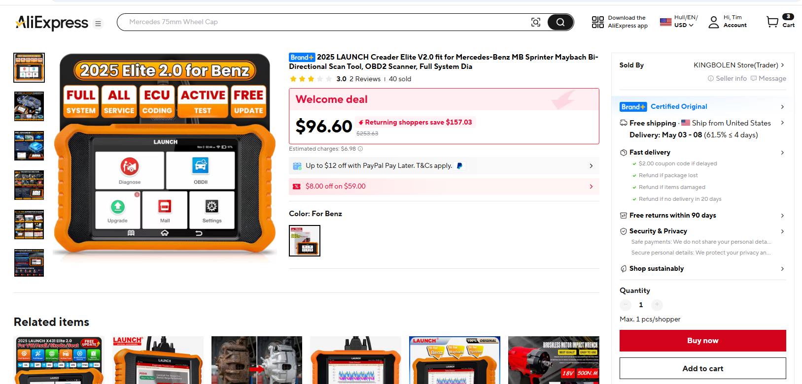

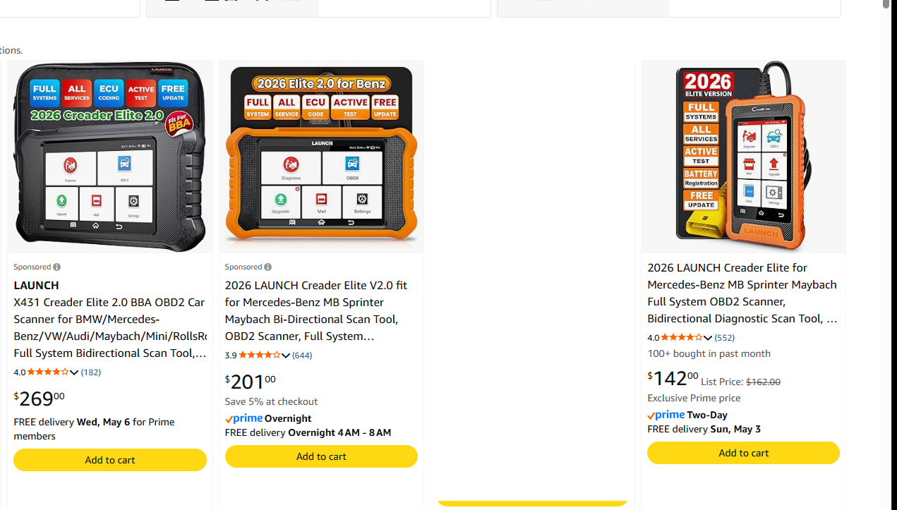

Need to scan the car and check for any fault codes.
if you dont already have a Mercedes specific obd scanner i'd recommend getting one of the Launch Creader scanners. Either Amazon or AliExpress. Any of the ones below will work for your needs.
