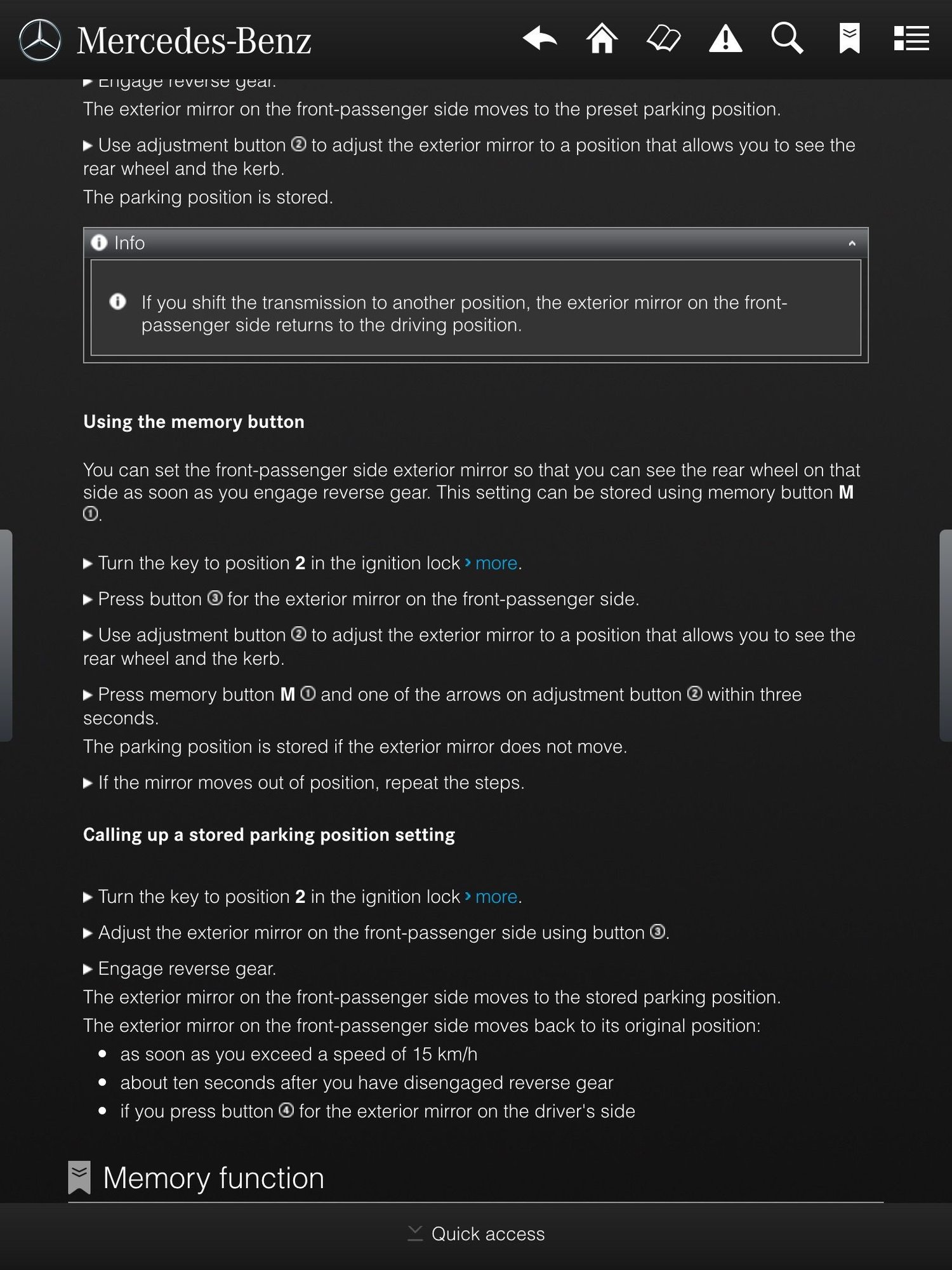

my mirror rolls in towards the car and up when i put the car in reverse to park, instead of what I would think the logical move would be out and down so I can see the curb when I park. Does anyone else have this happen?

Does anyone here READ THE F7CKING MANUAL????
The mirror reverse position can be set to go anywhere and its stored with your seat memory. There is a cadence of steps to do it. Just open the little book, or read it in thru command version, its right there!!!!

ive got hours and hours to read through the minutia of the manual. will set it when im back in the car. thanks
