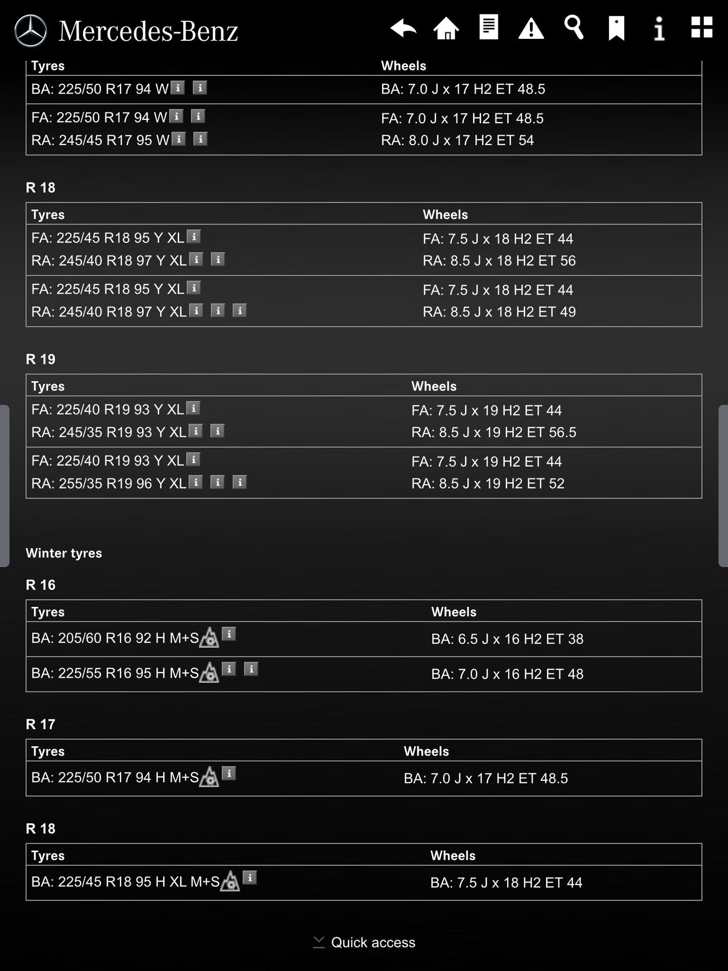

So I'm looking to pick up some cheap winter tyre/wheel combo's given we're entering the summer period and someone might have leftovers in stock from winter.
I've got the standard 19" AMG wheels on my car and I wonder if someone could help me find out their offset/ET so I can be sure I get the right size/offset wheels?

From MB Guide for the C200. 19" not listed for winter tyres

Brilliant, thanks for that. I'll be looking into 18s for winter setups.
