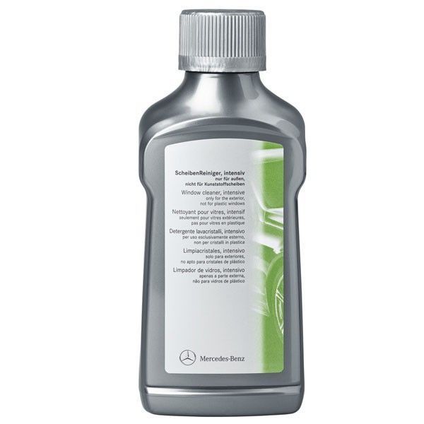

This is the product recommended by MB for wiper chatter. It is also listed in WIS as a solution for the issue. Hope this helps for future owners.
Part No: A0009864071
Old Jun 27, 2016 | 05:45 PM
Onemendo's Avatar
Joined: Apr 2016
Posts: 17
2015 Mercedes C300
does it work?
