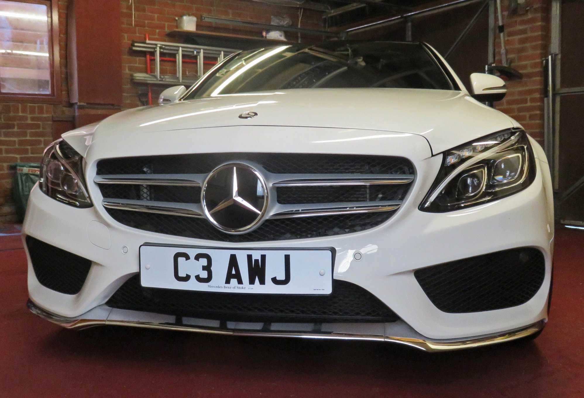

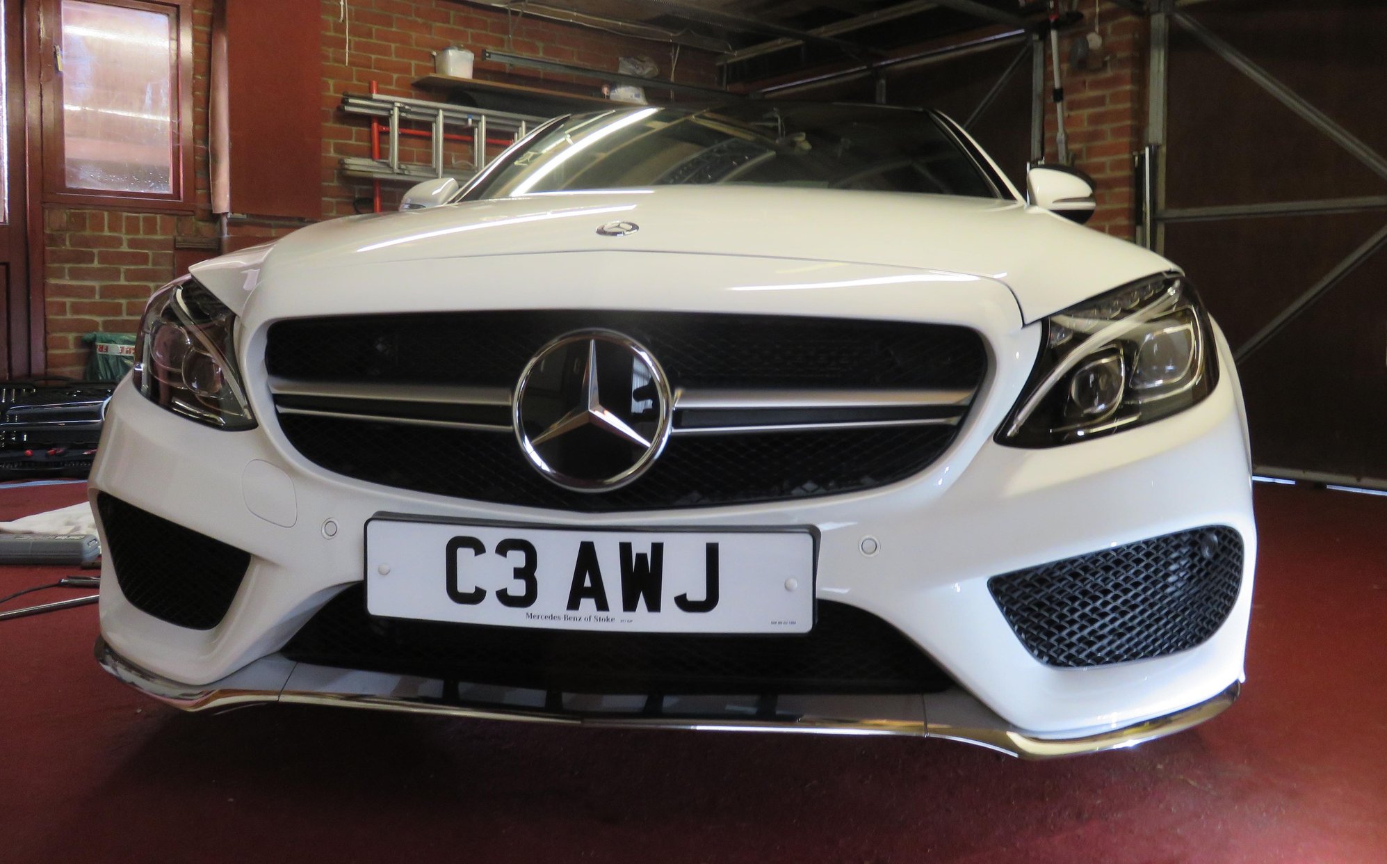

Well, 3 hours, actually.
My missus bought me a single bar grille for Christmas (how did she know??) - anyways, been really busy with work, since and only got round to fitting, the other day.
It was an import from Germany (but suspect it started life in China. I was really worried about the Distronic Star fitment but, while it is a COMPLETE PAIN IN THE *** to get engaged, it fits fine. (Tip - make darned sure you mark 2 things on the star while removing: 1 - Vertical (so you know which point is upwards) and 2 - Mark the vertical position where the star is released (so you know where to offer it up, when re-fitting) - trust me, you would think it would look obvious, but the fitting lugs on the new one look completely different.
One more tip - ALWAYS put down double thickness BLANKETS on the ground before you lay the removed bumper down - you will be surprised how "involved" you are with the back of it - all the time pushing down and moving it around, ON THE BIT THAT WILL SHOW, when you turn it over.
An awful lot easier than fitting a different grille to my wife's Audi A1 - a LOT less skin from my knuckles left on the inside of the bumper. Thanks to Vic Viper, the maintenance note helps, no end.
Before....
After....
Anyway, some will like it, some will hate it - but who cares, I love it. It has changed the whole character of the front end - it seems to look (strangely) lower from the front when you see it on the road.
So what's next...? I did like the look of that Roof Spoiler - damn, a long time to wait for next Christmas....
PS - One thing to note: I almost had heart failure when I test drove the car after. When I engaged the Cruise, after about 10 mins, it came up with a "Radar Detector Dirty, Seek Assistance" warning - even though I had not even touched it. After another 10 mins, or so it cleared up and has been perfectly OK. So the motto is: don't panic.
