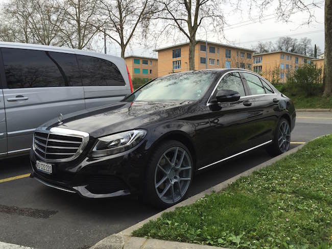

Ispiri ISR6
The car have these wheels (picture taken from a random car found on google) :

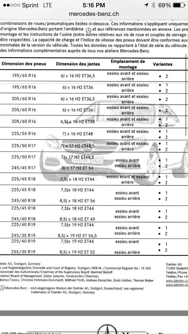

I found the offset on the swiss MB website (I live in Switzerland) :
http://www.mercedes-benz.ch/content/..._tyres/pc.html
Juste click "Download Classe C type 205 berline"

Right, for 19" wheels the factory offset for your W205 is 44mm front and 56mm rear. If you're going to 19" those would be your numbers.

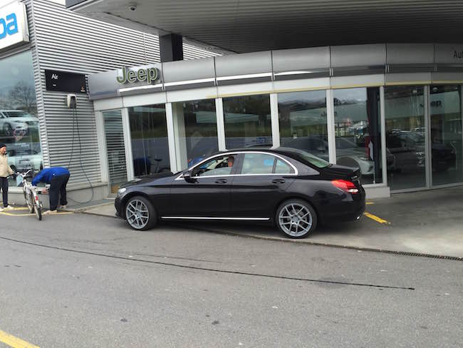

Hi guys,
I have the pleasure to tell you that this setup works on a non-full-AMG and non-AMG-kit. If I have some time and if the weather is good, I will do some fitment pictures so people who wants more details will find answers quickly
Attached Thumbnails 19x8.5 ET 45 square setup-img_5588.jpg   19x8.5 ET 45 square setup-img_5589.jpg
