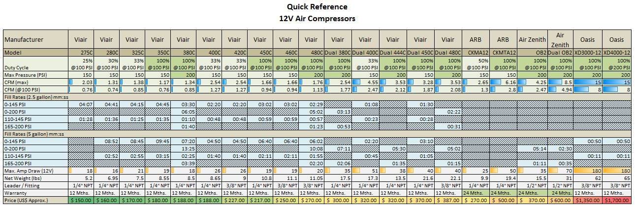

^ Yes Viair are definitely a good option. Just be careful about compressor selection. Most are designed to be connected straight to the battery and not a cigarette lighter socket due to the higher current draws.
Here's a chart of I made ages ago so pricing is a tad out of date perhaps but it'll give you an idea of what is out there. Most of these are designed for full vehicle air systems but the Viair line is available as portable compressors as well.
