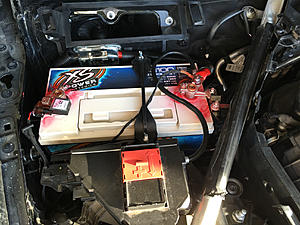

The cars electric system almost runs completely off the battery so bass and midbass notes can throw ECU into low voltage and when it try’s to recover it spikes the modules and could burn 1 or 2 up $$$$. You should look into an AGM battery to replace your OEM. I have close to 2500 watts in inefficient Class A and AB amps with twin 15†IB suds, 8†midbass in the firewall 6†midrange in the kicks and haven’t had a problem. All of this was looked at before we put this type of system in the car.
Lithium technology sure looks promising for the car audio as well.

wow, thats a serious battery. I am going back to the shop who installed my sub to have him check it out.
