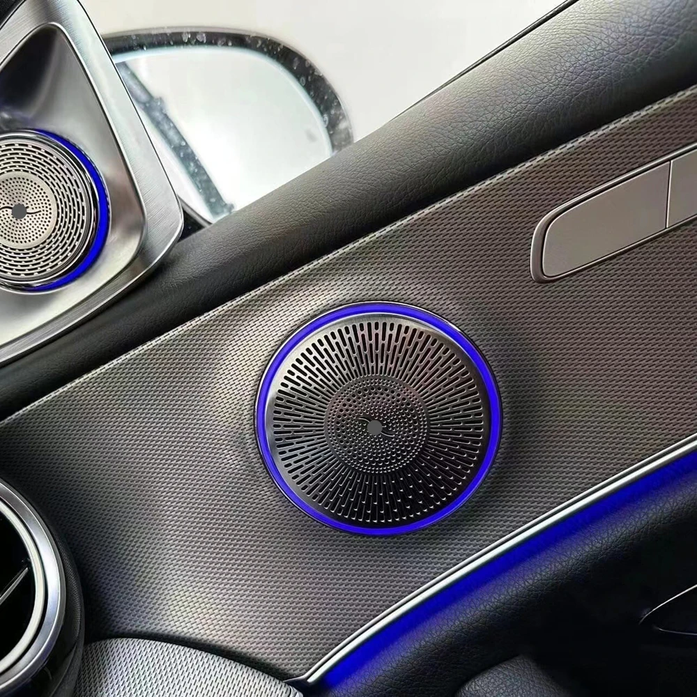

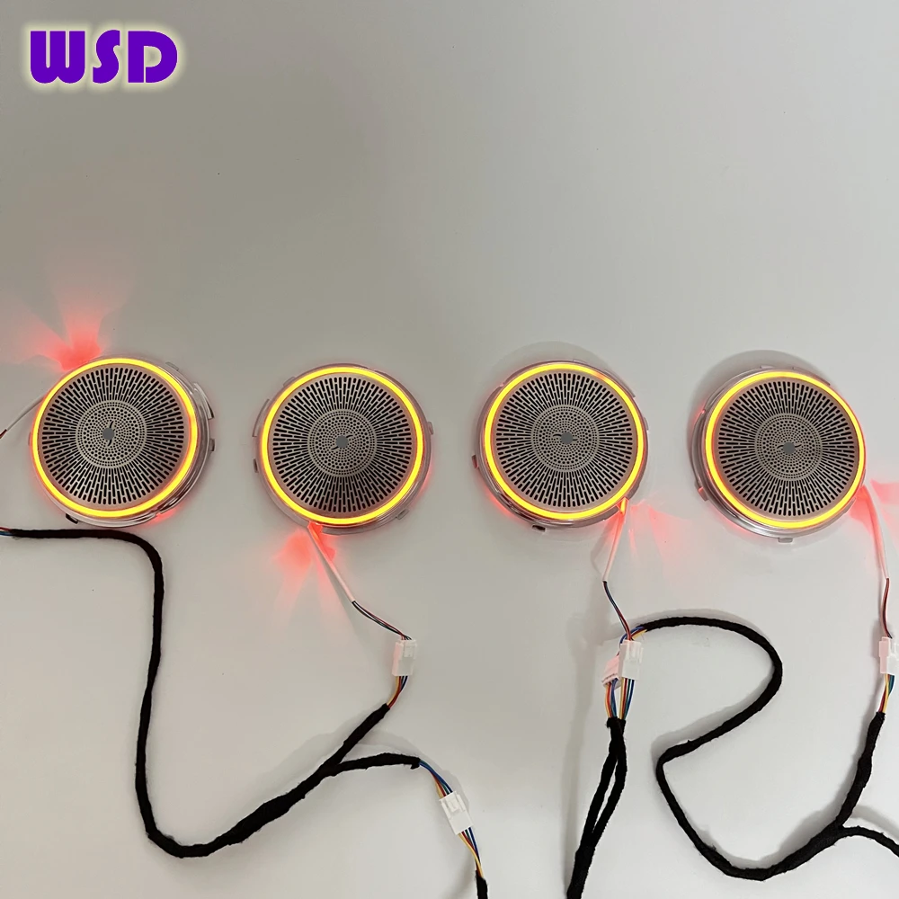

New halo style mid speaker covers.
Old Oct 29, 2023 | 02:30 PM
  #92
Doa's Avatar
Doa
Joined: Apr 2013
Posts: 1,130
Likes: 101
From: Belgium
W205
These are cool! Have not seen those yet so thx
Old Oct 29, 2023 | 10:20 PM
  #93
dagger22's Avatar
Joined: Feb 2018
Posts: 333
Likes: 102
2019 CLS450 (C257)
My friend installed this recently on his ride.... seems the new cover lights are brighter compared to the rest of the retrofitted ambient lights.
This can be fixed by adding a small inline step down converter to reduce voltage. Try 9 volts?
