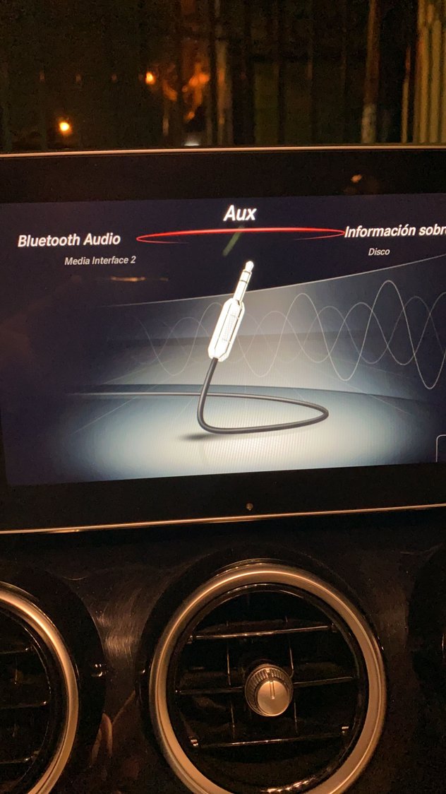

Old Oct 27, 2019 | 11:30 AM
Jalilc's Avatar
Joined: Sep 2019
Posts: 4
C200
Originally Posted by tejas10590
How did you activate your Aux? I also have 8.4 screen and wondering how to activate the aux?
There are various methods, all of them are easy.
1. Dealership activation
Supposedly, there is a way in which the dealership can get into the coding of your head unit and activate aux. I tried this option and we were actually able to get to the coding menu and find the option to enable aux (13.17) but the selection box to change it was greyed out and we had no luck on getting it to activate. Maybe they were missing some permissions or something else required to get this done.
2. Audio shop
There are some guys with some software that might be able to accomplish this (I’ve heard about Vediamo) this software modifies the coding on your head unit and gets your aux activated. Not everyone has this as it requires a hardware interface to connect to your car, so it has to be a specialty audio shop.
3. OBD Activator
This one the one that actually worked for me, there is a little device that you plug on the OBD port and within 5 seconds it beeps and your head unit reboots and voila! Aux is activated.
I spent nearly 2 months trying with options 1 and 2 but I could find anyone who could actually get it working until I decided to purchase this device and to my surprise it worked perfectly.
It’s important to let you know that audio gets routed directly to your head unit. The harness that they send is plug and play and contains the audio wires. The only thing I had to do was to connect the wire labeled AUDIO_GND to a ground in the car because audio was distorted. Other than that, everything was plug and play.
