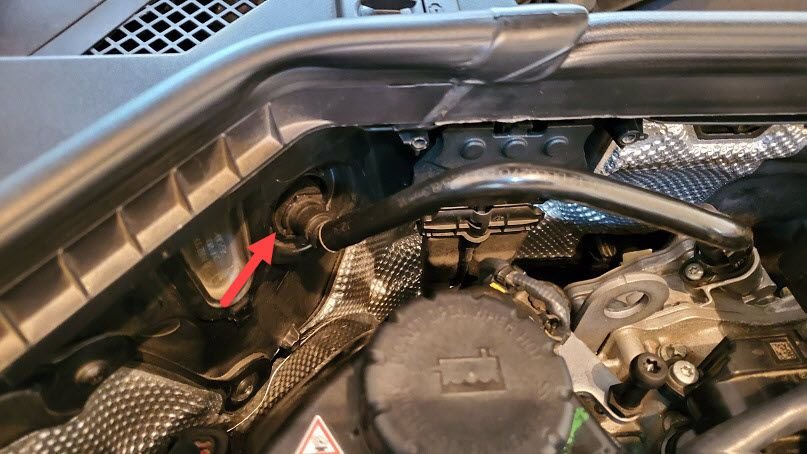

Did mine yesterday. The old plugs were 0.028 gap and the new ones also came pre gapped at 0.028. Mystery solved. I got 5 more HP!
Anyone know the part number of the rubber grommet around that hose? Mine is torn and the hose is loose. I wrapped some felt tape around it for now.
my grommet broke long time back as well, but so far no issues, as both the lines which connect are hard lines.
Checked in EPC, part number is A002 998 14 01, FEED-THROUGH GROMMET

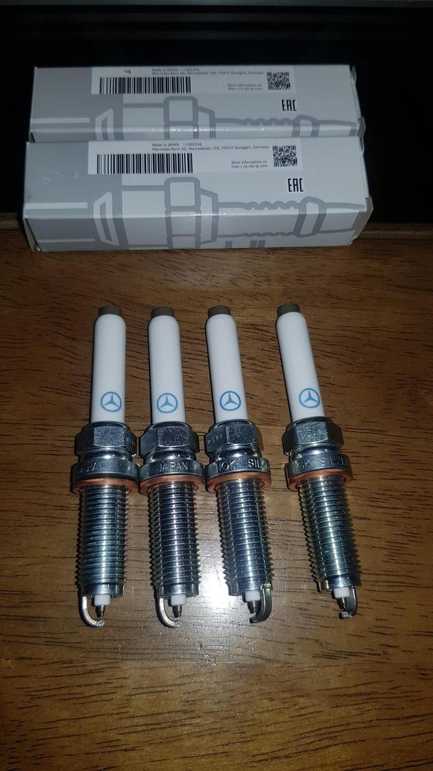

New OEM plugs going into the car soon.
These plugs came pre-gapped from 0.022 to 0.026 inches. I guess regardless of whether they are OEM or not one has to check for the correct gap.
Correct gap should be 0.028".
Torque to 23 Nm.
OEM NGK SILZKFR8H7S for W205 274 Engine

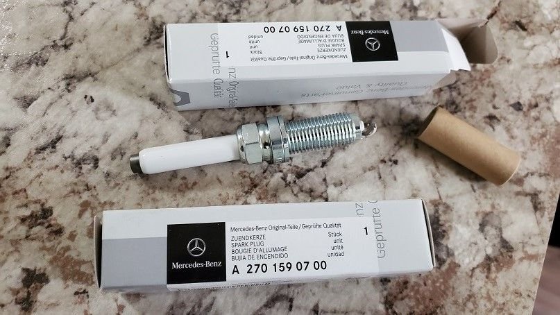

Vinay
New spark plug # is 2401590700 is correct. I just bought today for my C300, 2015.
There must be something seriously wrong with so many W205 C300 had misfired issues.
They change new spark plug for reason.
Hopefully this fix my misfiring cylinder 1 on my 2015 and 2016 C300.

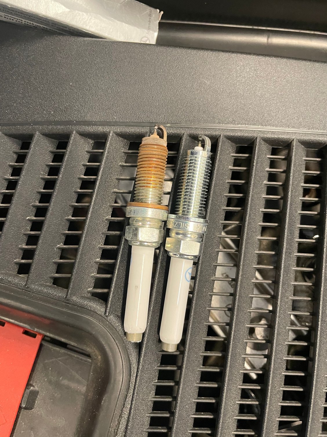

Bringing this back to the surface.
Changed the wife’s plugs on her glc300 yesterday. Just under 4 years (since purchase, probably 4 years to the date of the assembly line). 49,6xx miles.
plugs weren’t coming out “smooth”. Little bit of roughness and squeaking like they were going to get stuck in there if I left them in longer. Compared to my e300 I posted pictures of the plugs above at 3 years and roughly half this mileage , seems the corrosion (maybe from mixed metal copper washer) just works it’s way up the plug over time.
no wonder people break plugs sometimes when removing these. Note to self - change in the 3 year/50k mile intervals per that w205 bulletin
