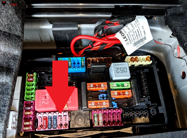

This is 445 fuse

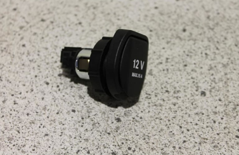

And original socket outlet

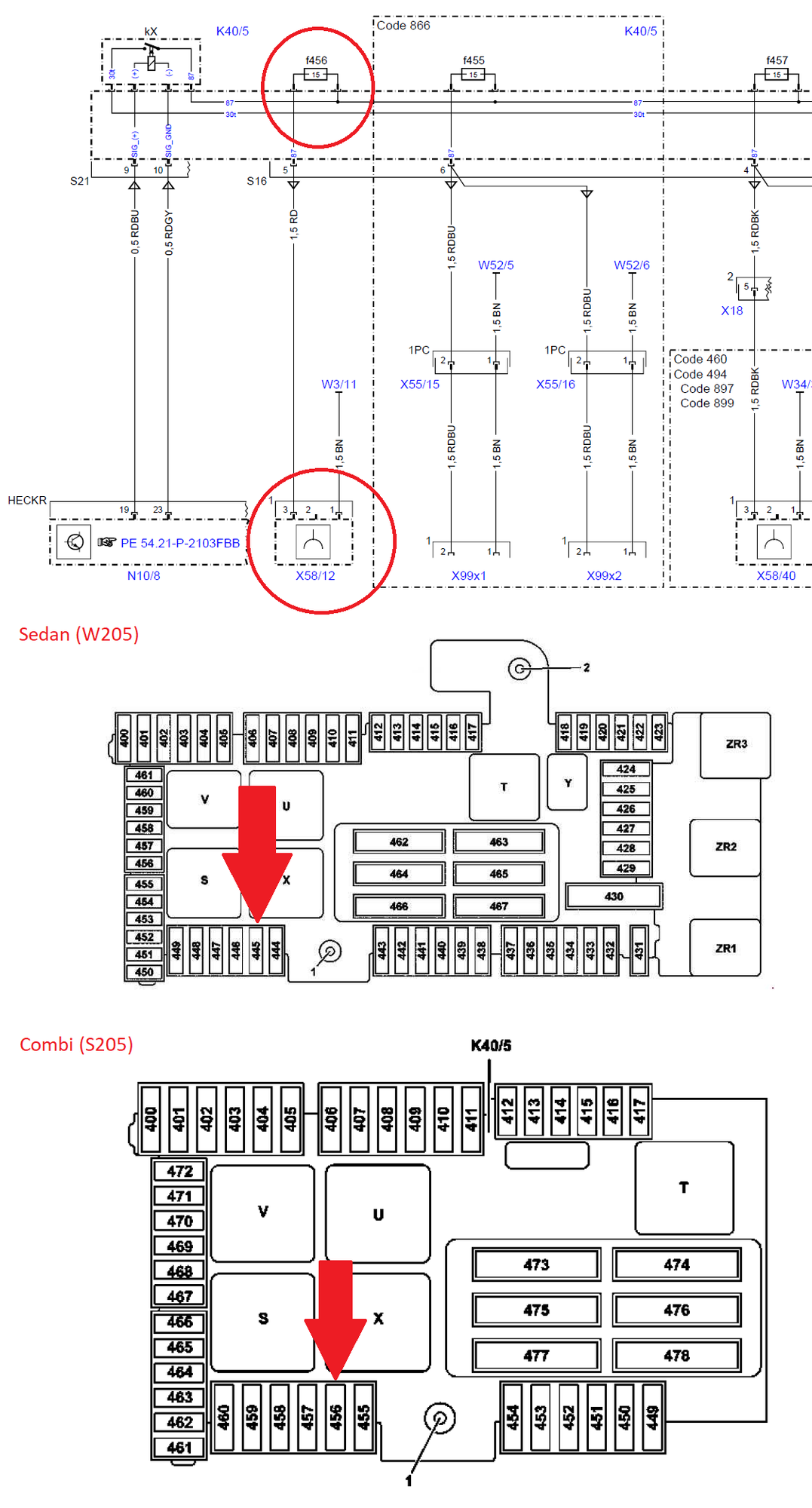

I studied, searched all night and found, that fuse 445 in rear fuse panel is for sedan (W205) and fuse 456 in rear fuse panel is for combi (S205). Here is electrical scheme:
