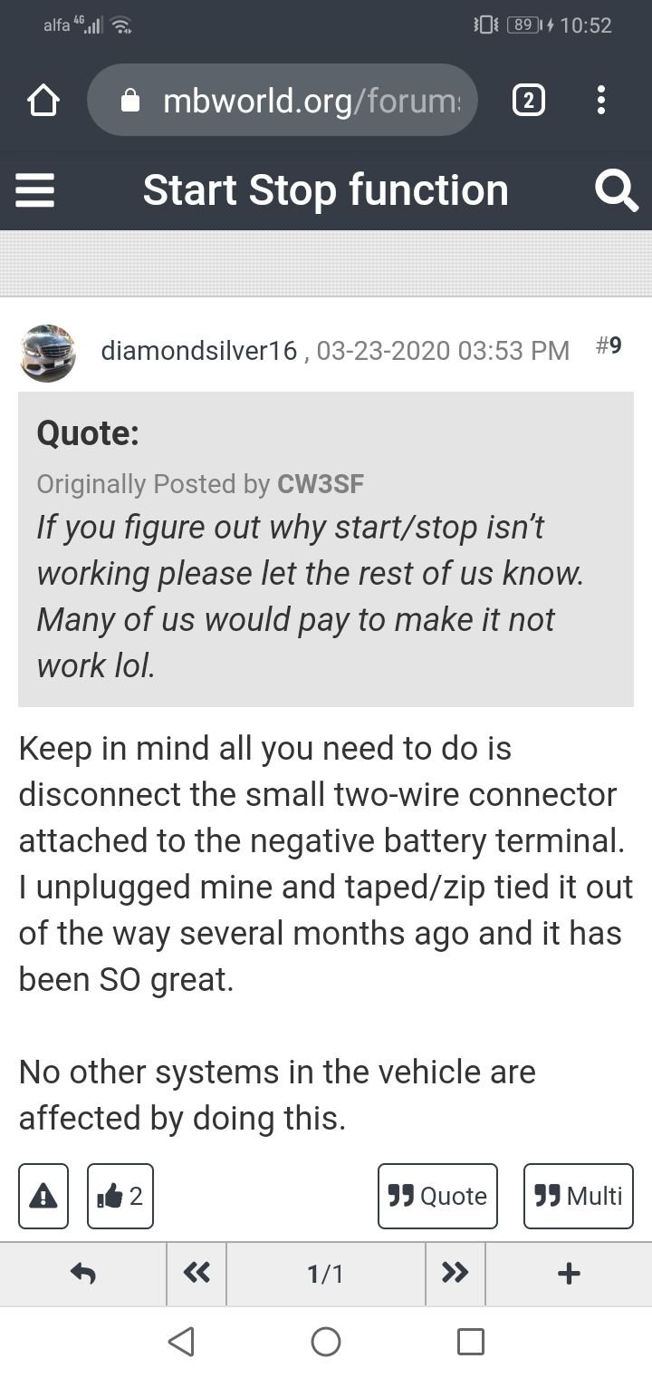

I just found this. It looks pretty easy to me and saves a lot of money. I will try it hopefully it wont damage ot turn off any other system 🤷

Originally Posted by Andy74
See what I found. It looks pretty easy to me and saves a lot of money. I will try it hopefully it wont damage ot turn off any other system 🤷
Yes, this is something that has been going around, but I tend to not wanna disconnect something based only on the claim from somebody on the Internet that it doesn't affect anything else. I believe what this disconnection does is making it impossible for the ECO stop/start to read the current battery charge and to avoid issues it basically stops turning off the engine. As far as I know it still logs a fault code. It's not a clean solution in my mind.
Old Mar 25, 2020 | 05:36 PM
Andy74's Avatar
Joined: May 2018
Posts: 1,249
Likes: 244
W205 2015
Yes I agree, I really dont want to create damage as fixing this car is expensive. I might end up with other issues.
Thanks for the information. It looks pretty easy to me. I think I will proceed with this guy.
$145 vs. unplugging a two-wire connector for free. Pass!
I am worried to end up with systems failure or going down due to disconnecting cables or wires from the main battery.
