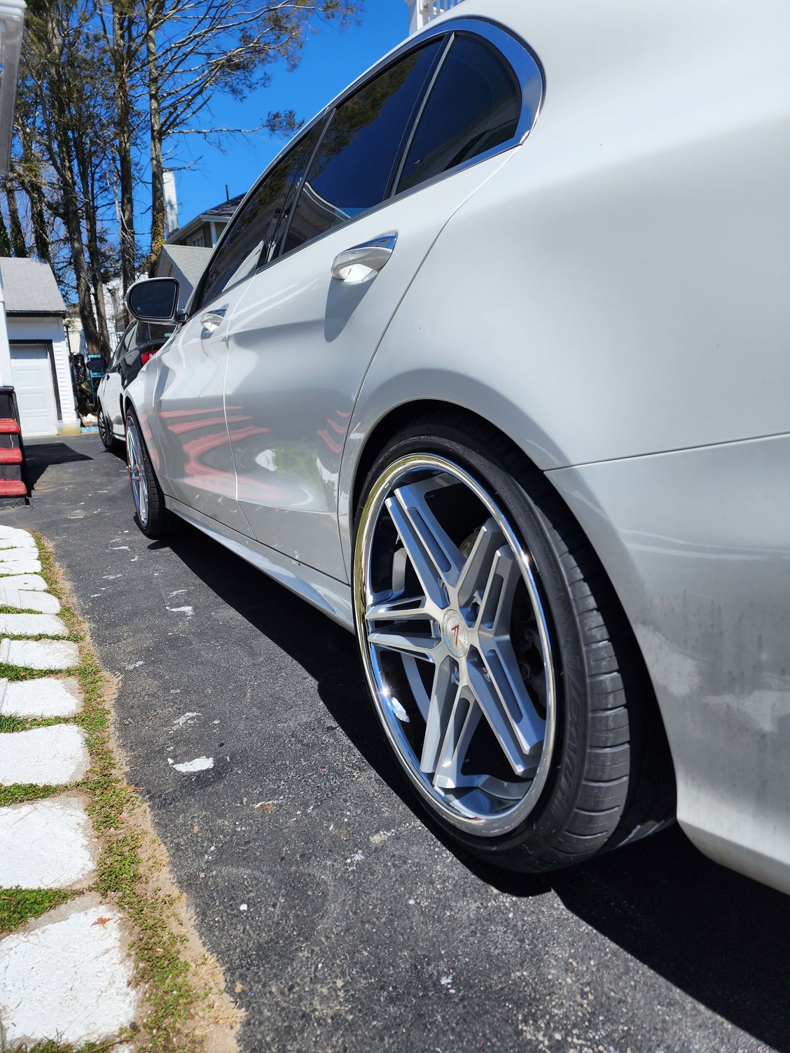

It's hard finding info with 20s on a W205. So I did mine. It's a 2016 4matic Sport version.
235/35 ET 40
275/30 ET 45
It sits perfect. Flush right to the fender.
A small gap, but it's factory / stock sport suspension

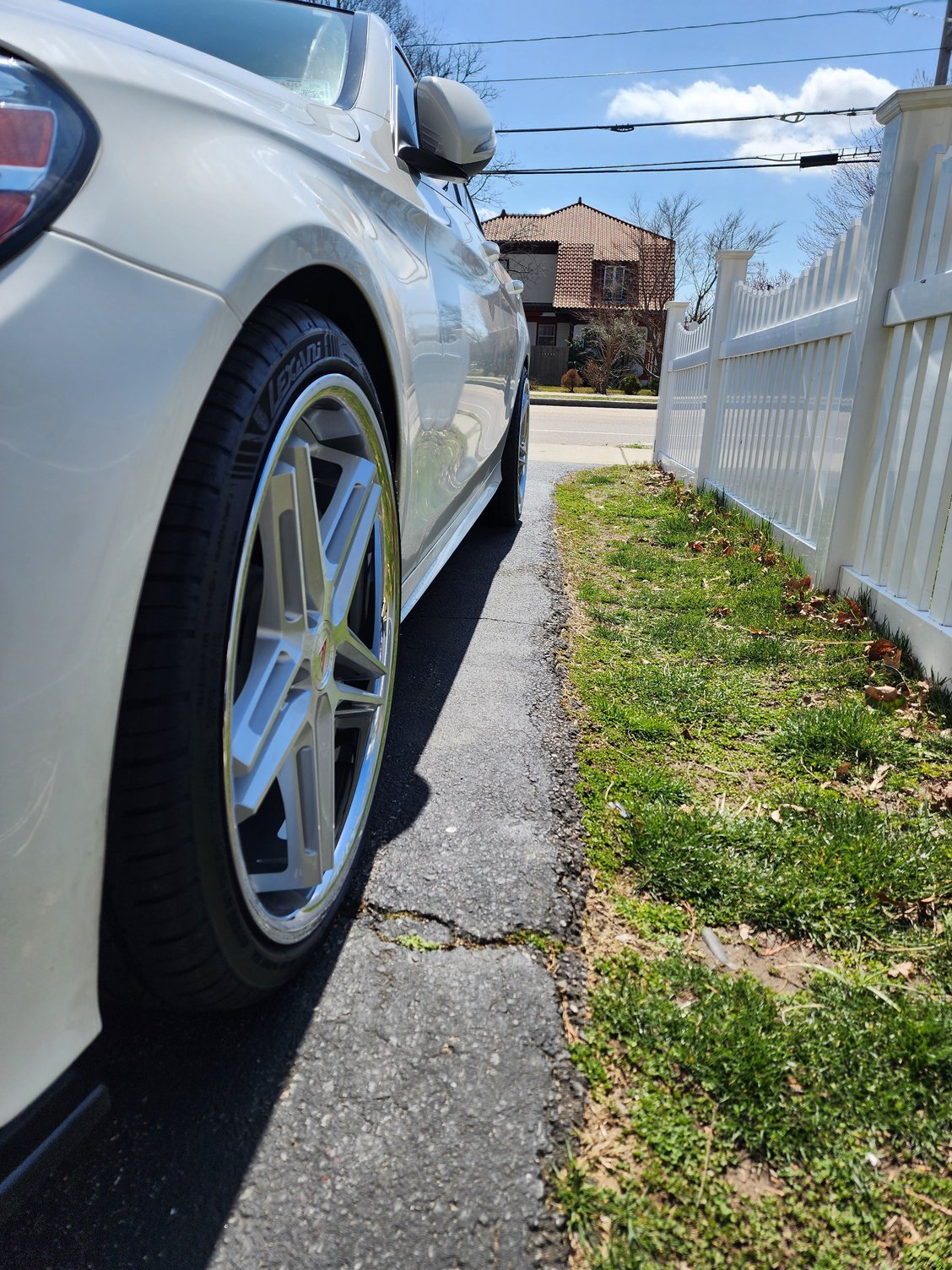

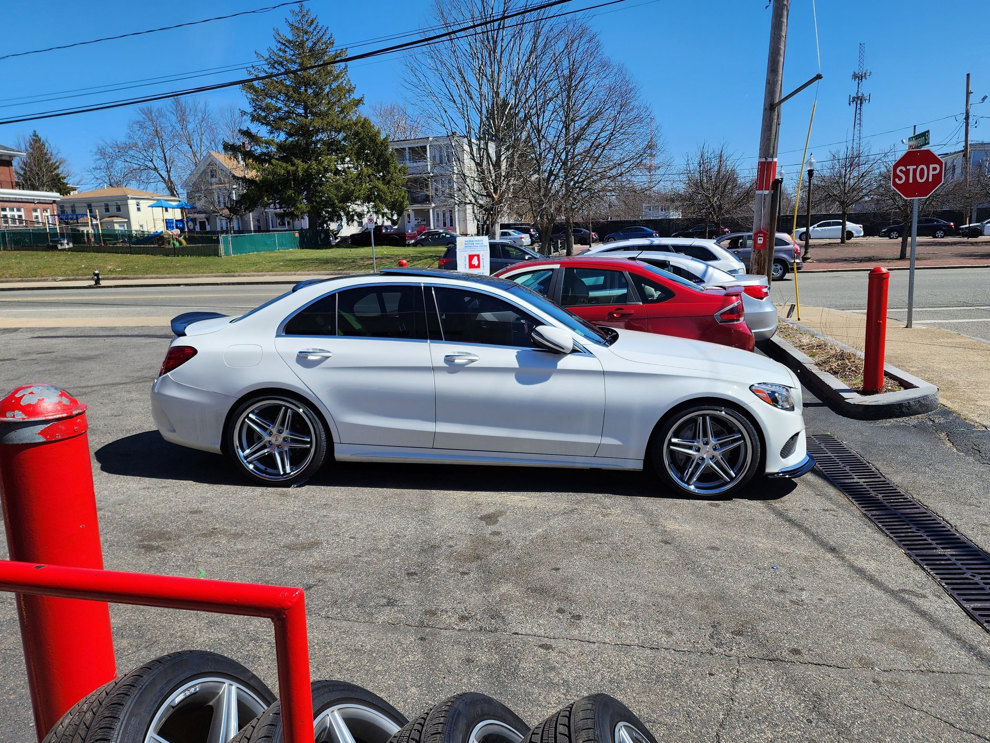

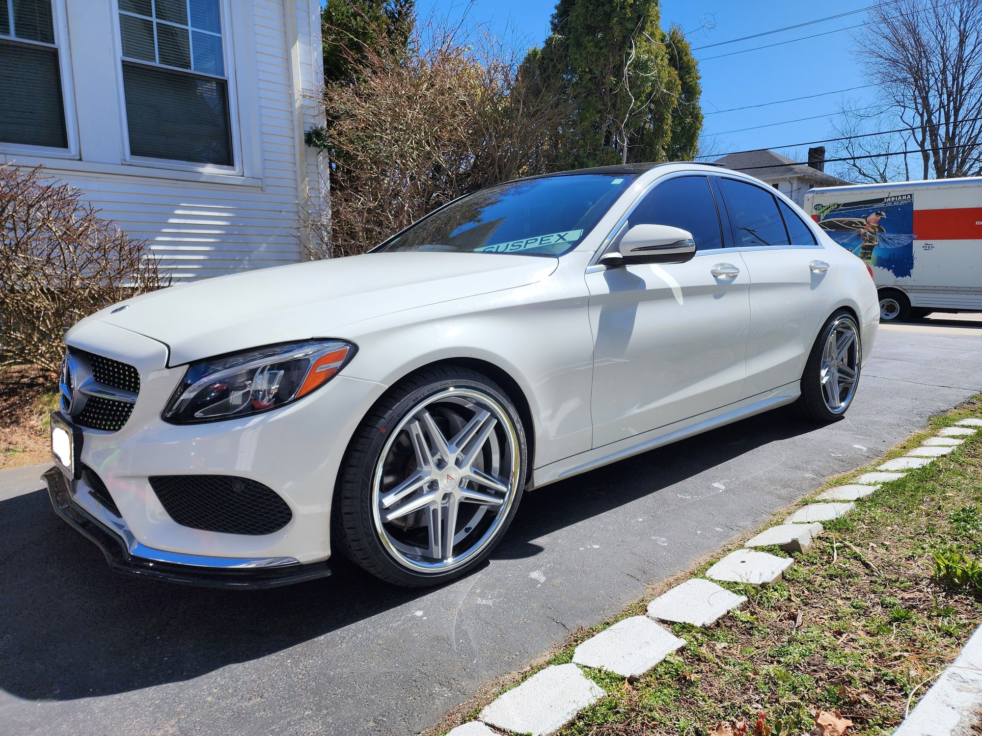

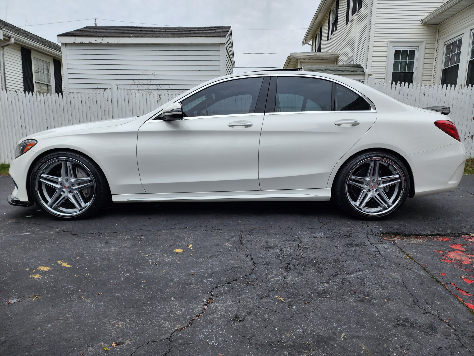

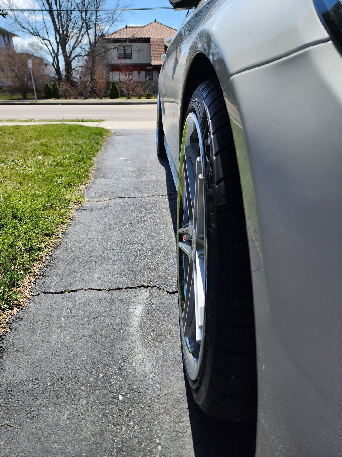

Old Apr 7, 2023 | 07:22 PM
arcangel_nickk's Avatar
Joined: Apr 2017
Posts: 11
C300
Yes, go with 20s. I did mine with 235/35 and 275/30 with ET40 and ET45. This is also stock Sport suspension.
Small gap but no rubbing issues.
On a level driveway
1st day i put em on
Flush
