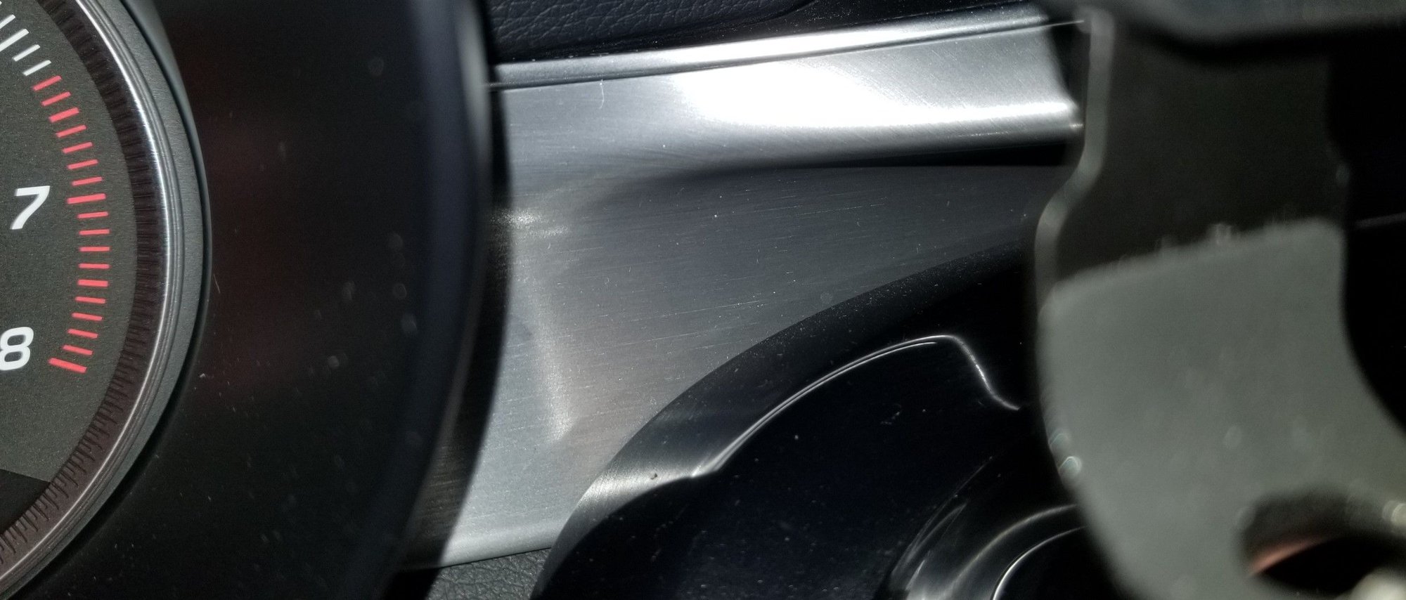

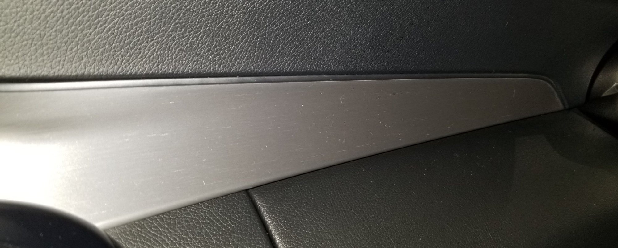

WTF is this s*** (trim bubbling)

Originally Posted by Cali4niadriver
of course I’m out of warranty, this is pretty crappy from a quality perspective. Like I’d imagine this might happen in 10 years, not 4-5.

It’s defective. I opened the glove compartment and noticed it’s sticky underneath it like the adhesive melted, also near the bubbles there’s like a square of sunken in spot. It’s just really weird how it happened. Although it has been hot for this time of year (90s) I kind of like want to wrap it with matching wood but I don’t think I’ve there’s a match for the gray open pore wood.

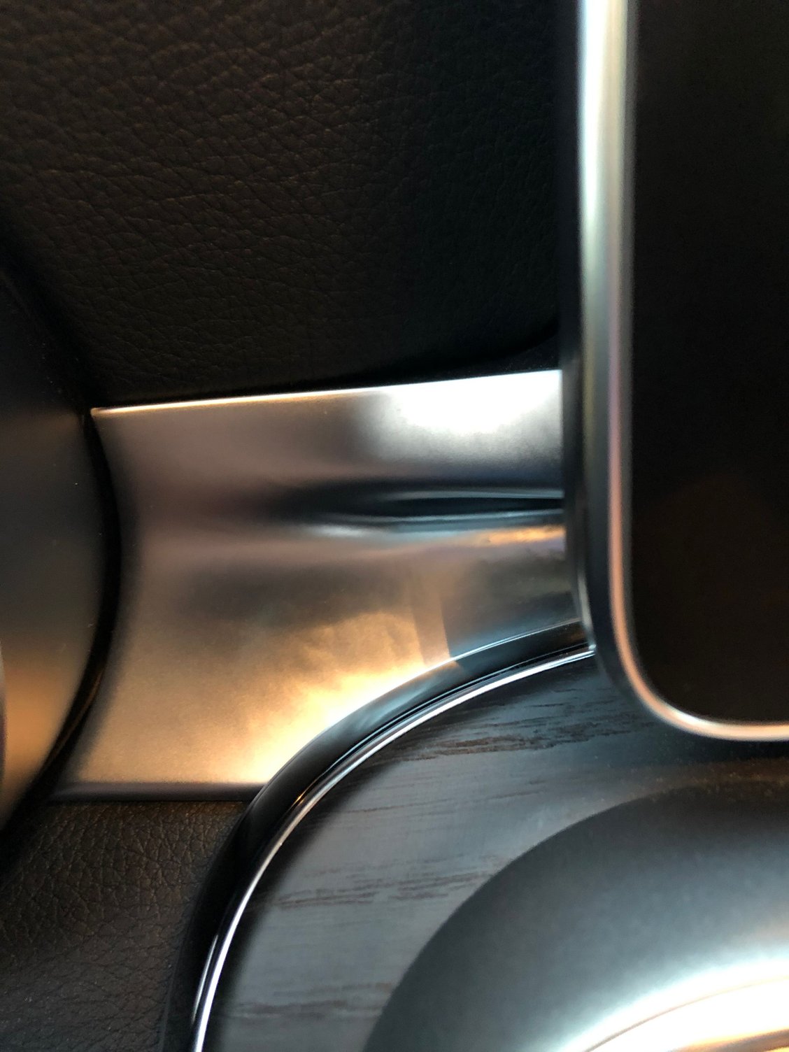

Mine in bubbling as well, I've never used a cleaner in the 3.5 years I've owned it. I just dust it with a microfiber cloth or a dust mop type duster.
And the black on my steering wheel is peeling:

I found a stainless looking trim piece on eBay to cover the steering wheel, I’ve thought about ordering it, it’s only like $20. Not sure what to do with the silver trim. My car is a CPO with a warranty until September, I may bring it in to see if they’ll cover it.

Like mikec35's car, my silver trim on the center console was also bubbling. But it was like that already before buying my car. I took it apart, peeled off the bubble by hand, sanded it, put some extra vinyl I had laying around on top, heated it up with a heat gun & called it a day for reinstall. A new piece costs $80+ (205-680-38-11) so, save yourself some money. Gonna re-wrap without the inlay "design" this weekend along with cleaning my dusty interior :
Top Left
Top Right
Center
Center 2
