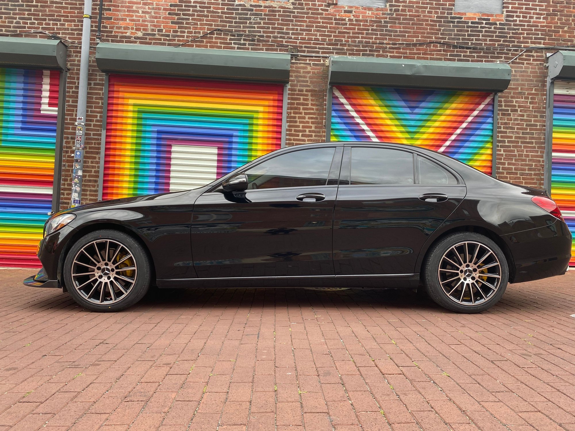

I got a set of 18x8.5 +45 with tires for my 2016 c300 4matic. Went to put them on and they are hitting the control arm. I love the wheels I got but want to be safe. Any ideas?

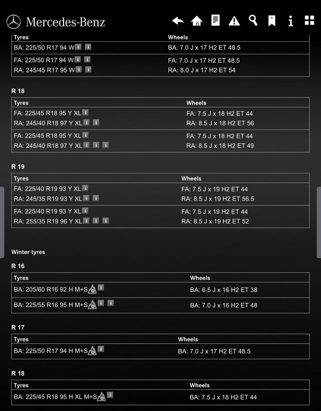

Offset off? See OE specs below:

Just noticed your wheel width. Looks like it's too wide a wheel for the front. OE spec is 7.5. Maybe people who know better can chime in.

Gents, they fit. I took it to another shop and they properly measured. They even tested the new ones for rubbing but she’s good to go!

looks good!

Looks like they are AMG Line wheels, 19" for an AMG Line vehicle, yours looks like a lesser spec sport model, correct me if I'm wrong. If that's the case then some adjustment would be needed. The spec list for my car shows something regarding adjustment for AMG wheels if I remember correctly.
