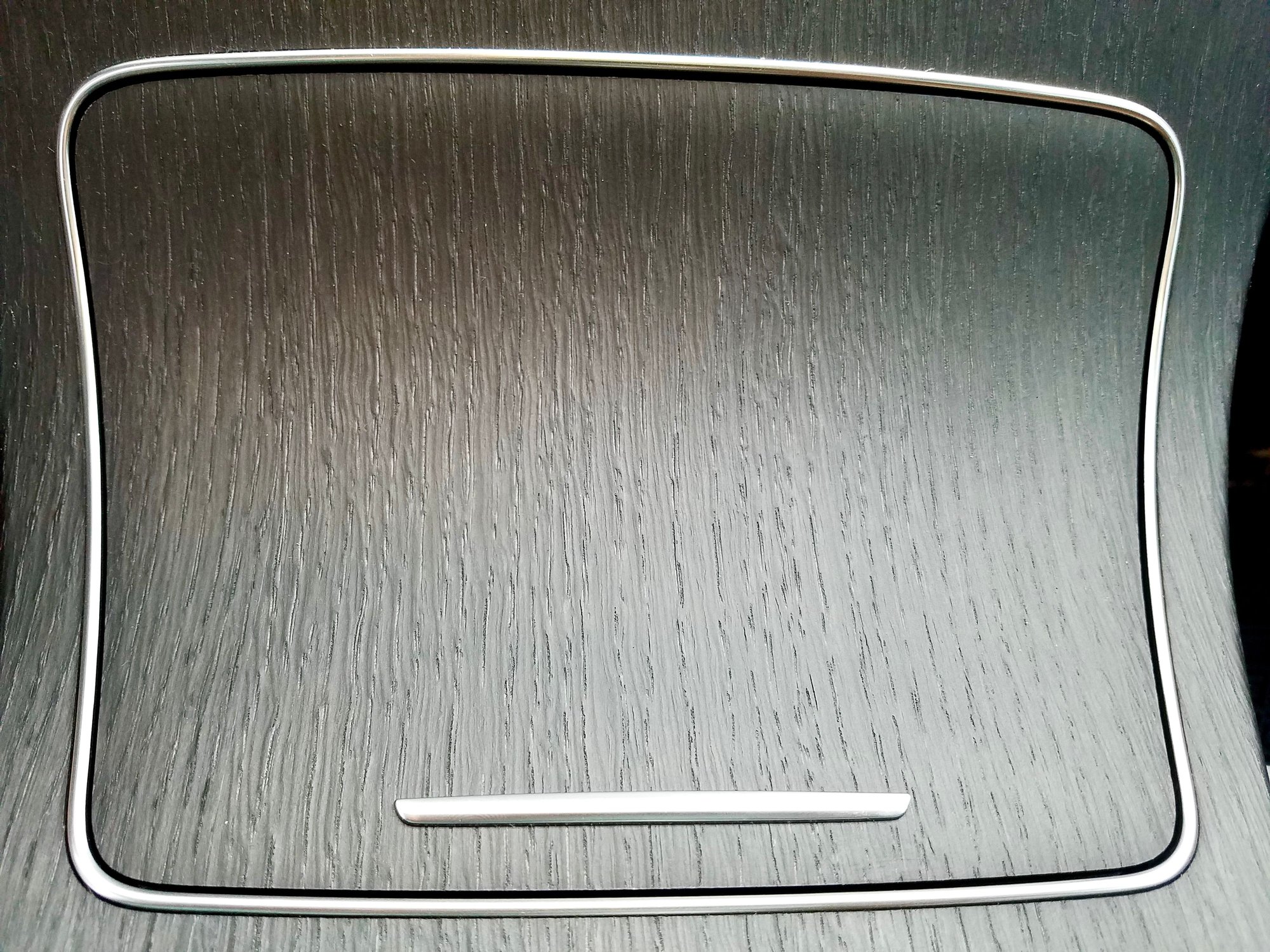

Step 2
Drill a hole in the front of the small cubby hole in the center console:

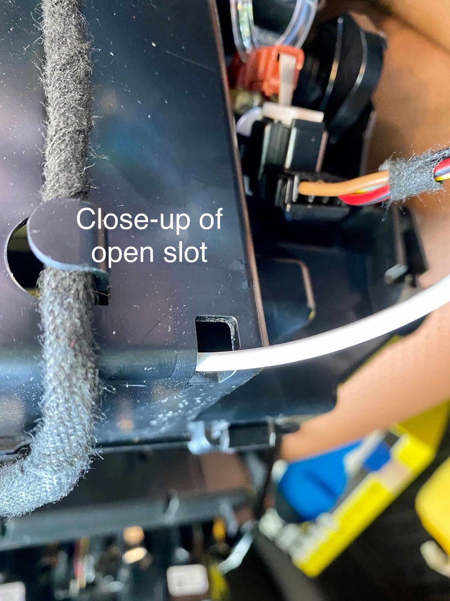

Step 3
Remove the ashtray and route the cable through one of the open slots in the bottom:

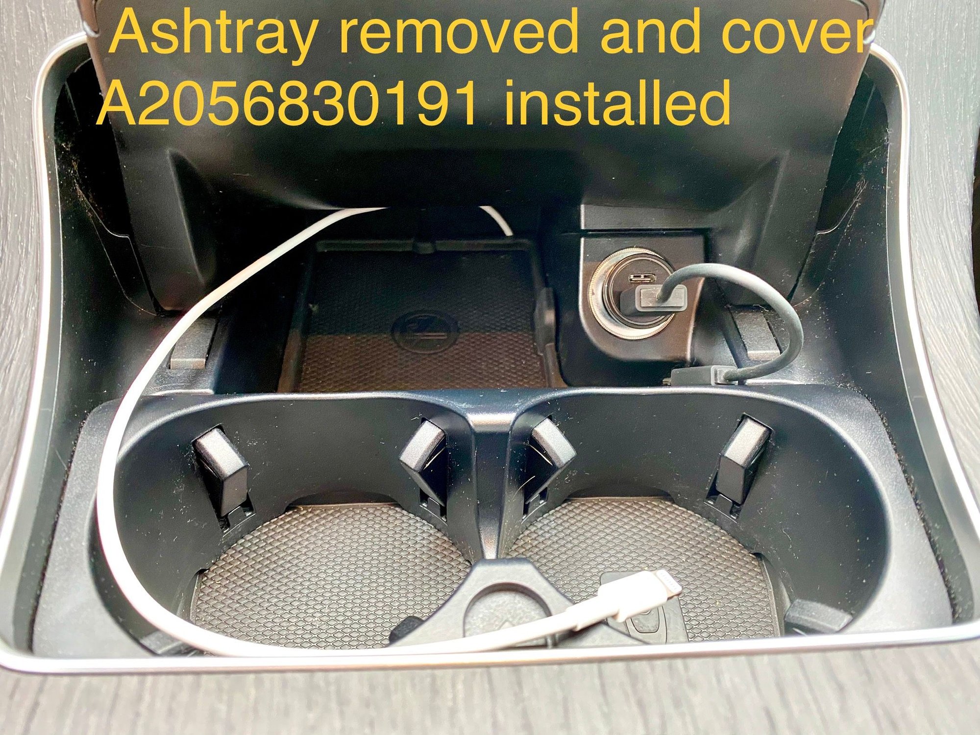

Step 4
Install cover/pad:
Finished product!
Phone plugged in with data/charging cord and hidden:
