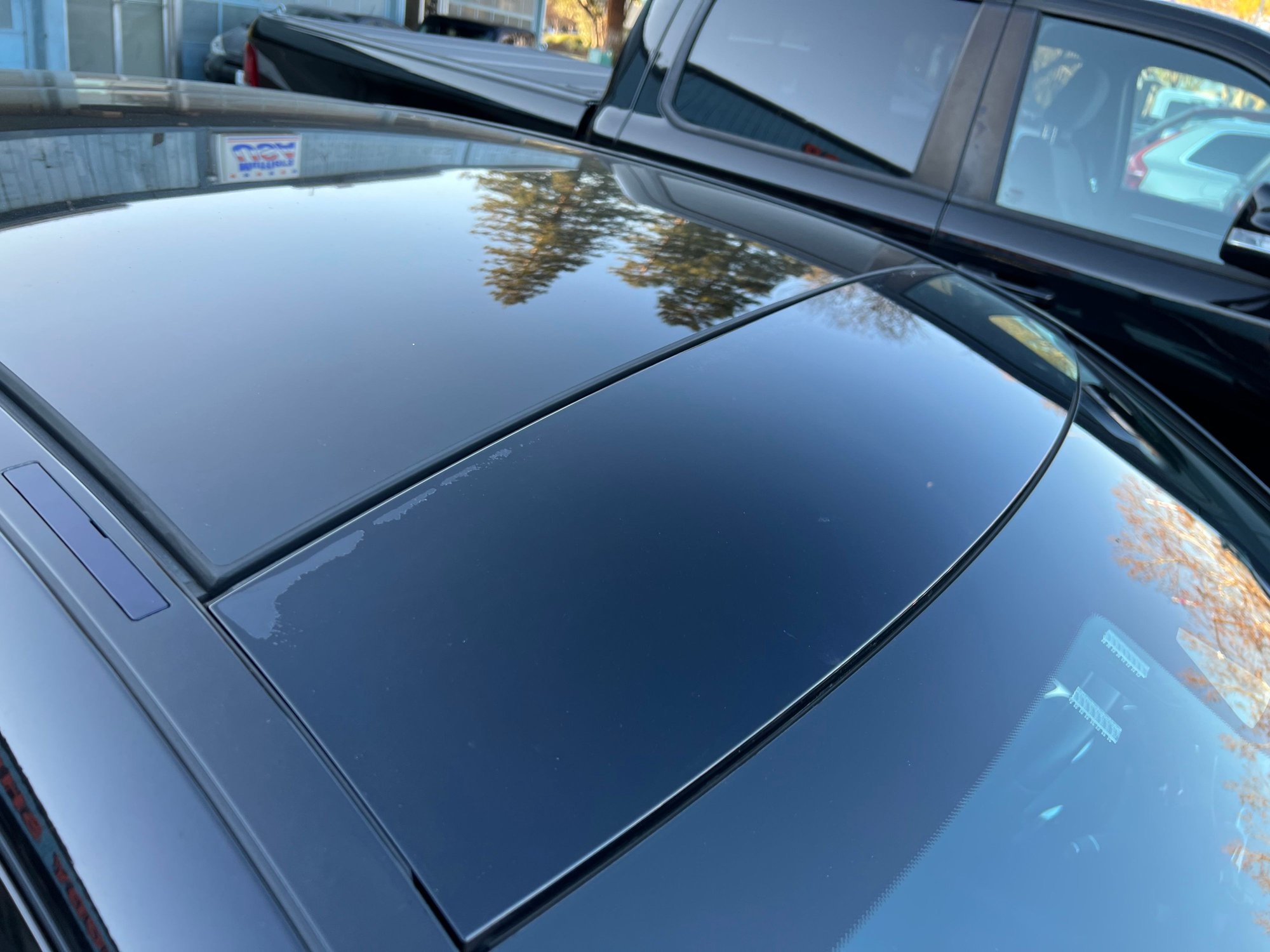

Hi all, I have a 2016 C300 that I just noticed is experiencing what appears to be oxidation or delamination where the windshield glass meets the panoramic roof glass. A couple of pics are included below for reference. I purchased this car as a CPO with 33K miles in December 2018 and it currently has around 57K miles. I purchased the additional 2 year extended CPO warranty when I bought the car. Any idea if the dealer will fix under warranty? My fear is that Mercedes will say this is a cosmetic/environmental failure and will not cover under warranty. If that is the case, any suggestions on a DIY fix or at least how to prevent further deterioration? Thanks!

Pretty sure that the panoramic roof is specifically excluded in the CPO warranty. Some people have wrapped it in black vinyl.

It's UV degradation of the clear coat over that plastic body piece - a competent body shop can sand and re-shoot it in place for like $100.. and the new clear coat done here in the US will be more UV resistant - done once - you never have to look back..

Has anyone had this repaired outside of warranty? I took mine to body shop and they suggested that the piece could not be cleaned up and would need to be entirely replaced at a cost of around ~$1k.

Had it done under warranty last year. Took the glass tech few hours and he removed pretty much everything and replaced support trims as well. Imo, getting it wrapped for $100 would be the best route.

Darn, exactly what I was afraid of- impossible to refinish the piece. I think you might be right that covering it up with a wrap is the way to go. It's a shame that these parts have terrible cosmetic issues despite being well cared-for..

Anybody happen to have access to the replacement instructions? It seems that the part is about ~$550 online. If it is not too crazy I might try and replace it myself and then wrap it to keep it from happening again.

In case anyone else is ever curious as to the cost and results for a repaint here they are: $250 for a refinish here in the Bay Area.
