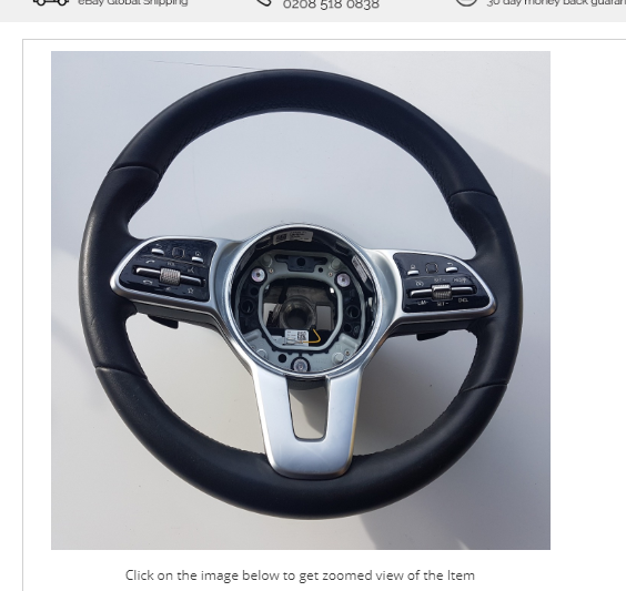

Hello everyone,
My first post here. I have a question about a steering wheel that I want to put on my S205 2014 C220. I've attached a picture with the steering wheel I want to put on my car. The question is, what exactly do I need so it can work( I know that I need the airbag but any extra devices or anything), I saw someone fitting an adapter for the wheel to work but the instructions weren't 100% clear. I live in UK so if you could leave some links to all the things I need will be great.
Thank you.

hi yes an adapter is needed and an airbag same connection as yours, if yours is a dual stage I suggest getting a dual stage, this saves you getting the car coded

Steering wheel adapter
Wiring is easy to do

I have done it. Mine came with its module so basically I removed mine and installed the AMG facelift steering wheel. Everything works except the cruise control. The existing cruise control stick still
works. I bought it from these guys:
http://www.eurohausmotor.com/
