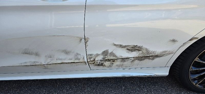

My driver's side mirror used to stutter and jerk when closing. Last week some guy hit it with his trailer and the whole thing exploded.
The mirror fell out (hanging by the wires), the cover ejected and whole assembly bent all the way forward.
I thought it was a total loss, but surprisingly everything snapped back together easily. Not even a scratch.
Kudos to Mercedes on this great design!
Oh, It also doesn't stutter anymore.

Seems like a "happy" ending
Only for the mirror.
