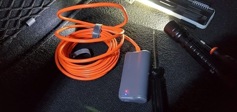

I also got a 5.0MP Wireless (wifi) Endoscope (which has a camera and light at the end), so I could see inside the AC system.
This tool has come in very handy in many projects.
