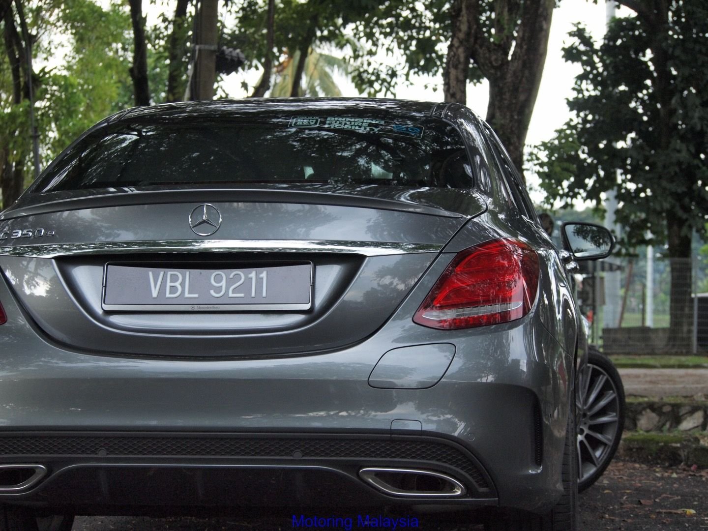

I don't get it. The c350e is also optional with the amg style exterior pack so such bumpers exist

I don't either because you are 100% correct, and the build is irrelevant because all rear bumpers are interchangeable.
OP, just order the C350e AMG line bumper, shown above.
