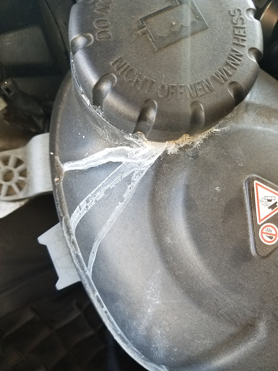

I took the baby out for some groceries and sure enough the light went away. What tips could you give me ? I want to go into the dealer with some knowledge. Also I noticed some 'spew over' on the coolant reservoir and an 'oil looking spot' on the intake port. Just want to be ready. I wrench a lot and want to make sure the dealer doesn't think they can screw me over. So to say.
