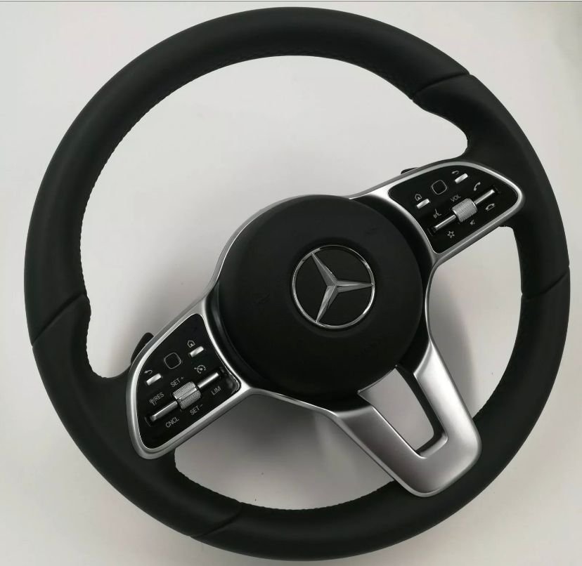

I have a 2016 and was wondering if any one knew if I could swap my old steering wheel for this new one. So just plug and play

I swaped mine from 2015 AMG line to 2019 AMG. I have to say that the last came with a module and its own airbag.

It is possible but it won't be direct plug-and-play. You may need to change the steering column module (the one that the steering wheel mounts on) to accommodate new pin connectors. The job is not that difficult but it is the question how much money you want to throw at it.
