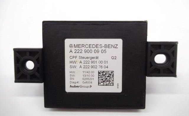

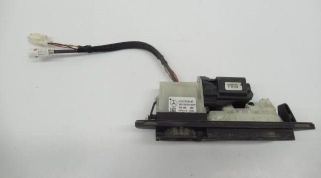

I have the handle with camera A2227600893 and I assume I need control module A2229000905 (attached pictures). What else?

- Camera
- Handle
- Harness (A2055402234 fits in my S205 MY2016)
- CPF (control module)
- Coding HU and RVC (camera)
Attached are wiring diagrams of handle and camera.
