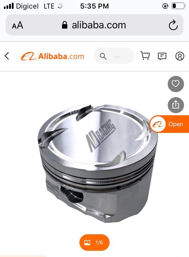

Doing my second engine rebuild on a car with just 20k on the dash. Can anyone just tell me straight up if there’s an improved oem pistons because clearly the first batch crack and break. Yes or no?

to be honest I have no info on the new ones but here’s what I’m trying to get. If you go genuine it’s gonna be the same issue so I figured I will try these out
