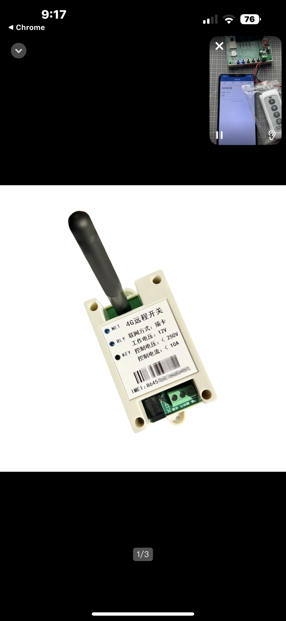

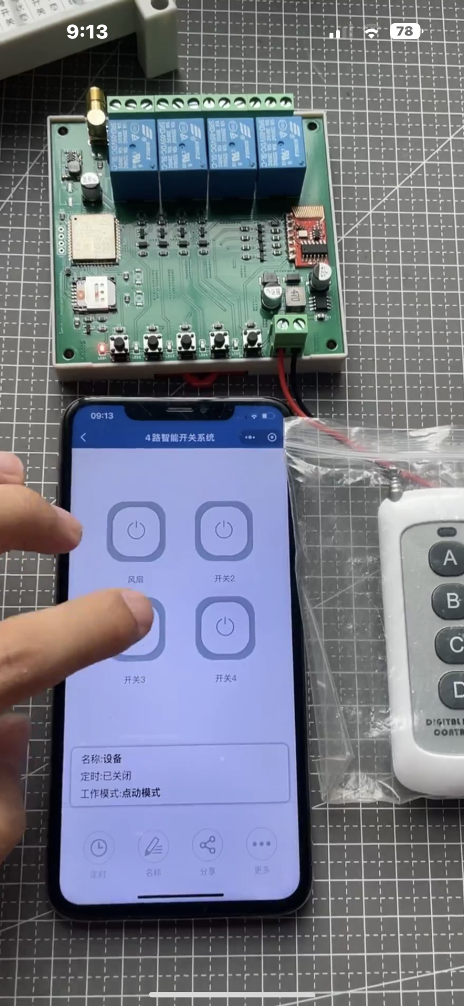

Alternatively, buy one 4G switch from China $50 at most, then from your smart phone you will have some buttons in one app. To do this job easily.
in the car you need open the AC switch panel then find the two contact points of that button. Then hide the small switch behind it. It will work for sure.
but you need buy one extra SIM card for this and pay monthly for the data. If you think it worth the spending, go ahead. One more thing is the power supplier issue. You need source the lowest standby current device. So it won’t drain your battery. And if you need park the car for a long period: better cut off the power supplier.
So if you want to make it by yourself, it will be more fun. But if just for this function, not necessary to dig into the CAN BUS. Just my two cents
hope you get it done nicely.
Cheers!

$20 with 4 way switches by 4G support timing
1 way 4G remote switch: smaller size.
