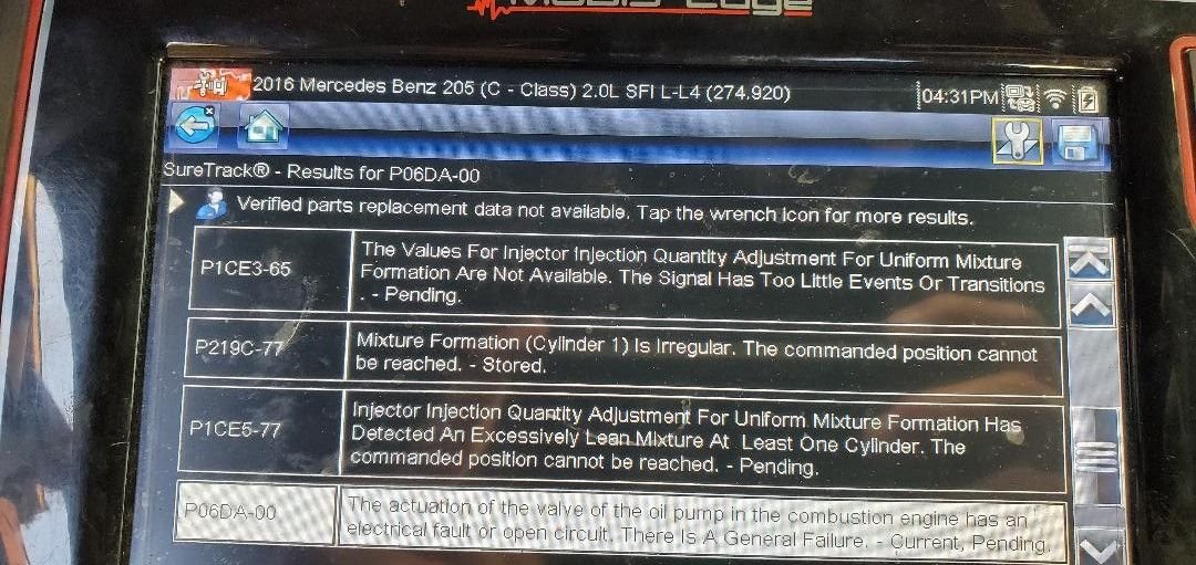

Do you have any drivability symptoms ? I was driving my car to work this morning , upon a hard acceleration, check engine light came on and felt loss of power , check engine light started blinking ( misfiring ) long story short , got towed, when loading up on the tow truck, a bunch of smoke came out the exhaust , I have cyl 1&3 misfire codes / P06DA00 / and P1CEF85 which is your code .

I had all those code plus p0301, p219c,

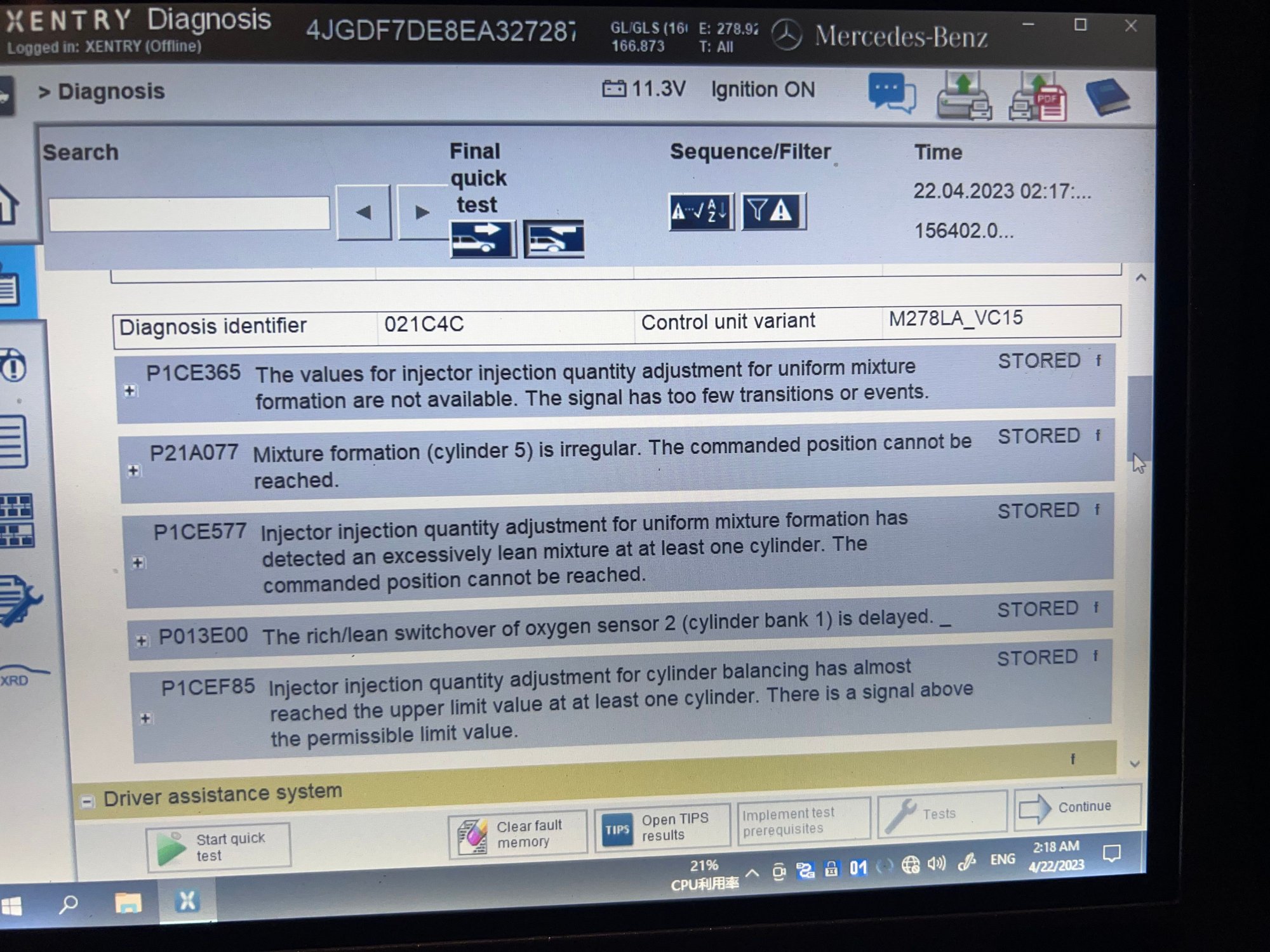

Old May 18, 2023 | 01:27 PM
Htownbenz's Avatar
Joined: Sep 2019
Posts: 16
2012 Mercedes e350 coupe, 2014 Mercedes gl550
These are the codes I have
I have a gl550 , 2014
Old May 19, 2023 | 09:08 AM
